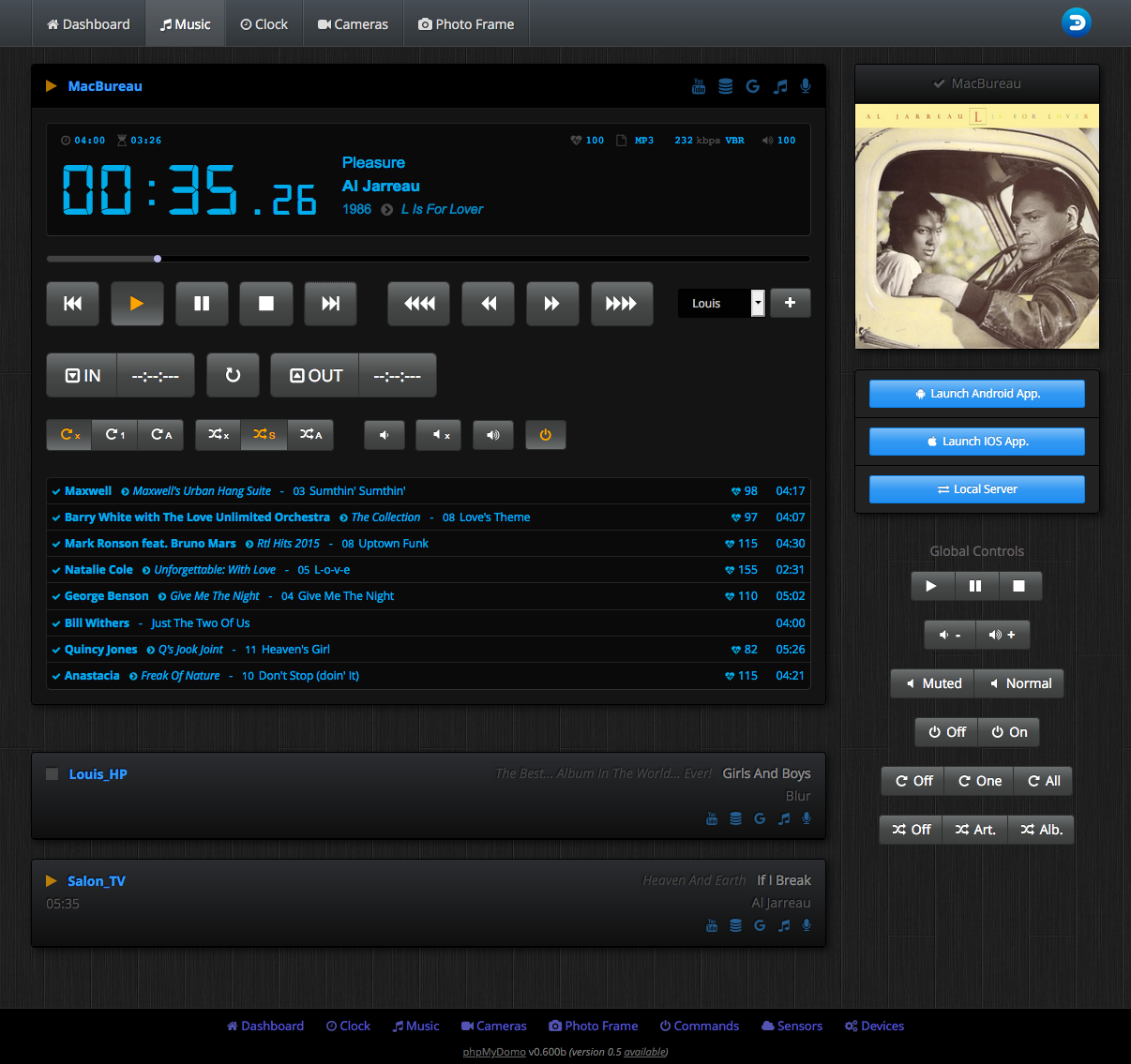

New Squeeze player:

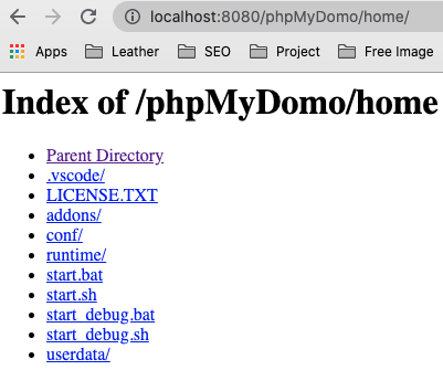

I am new openhab, and i trying to install openhab with PHP and Mysql,If you have any suggestion please let me know
Thank you so much
Sanya
Sounds like your webserver is not configured correctly…
BTW the files listed above are not related to PhpMyDomo in any way
