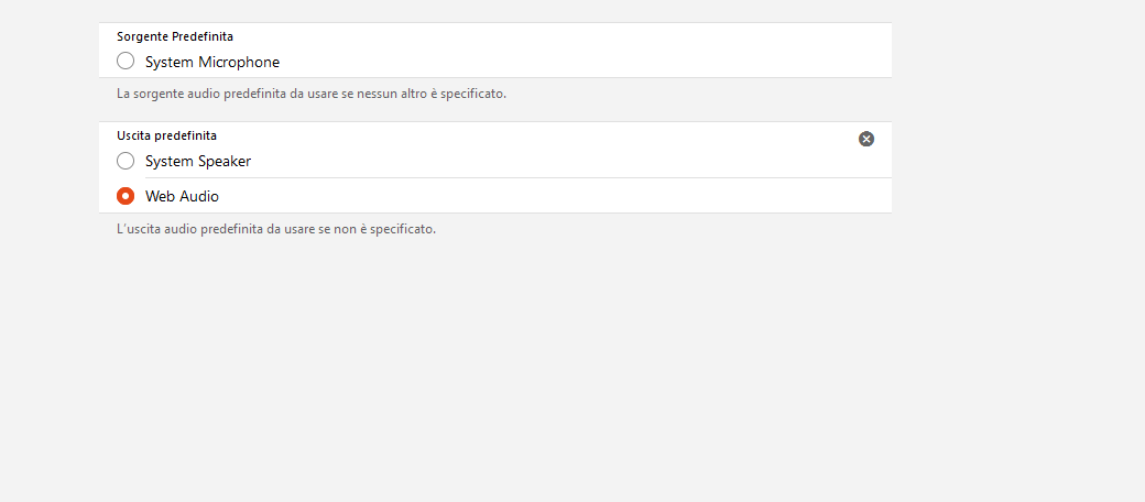

I have enable “Web Audio”, in the setup
And I have enable web audio sink
