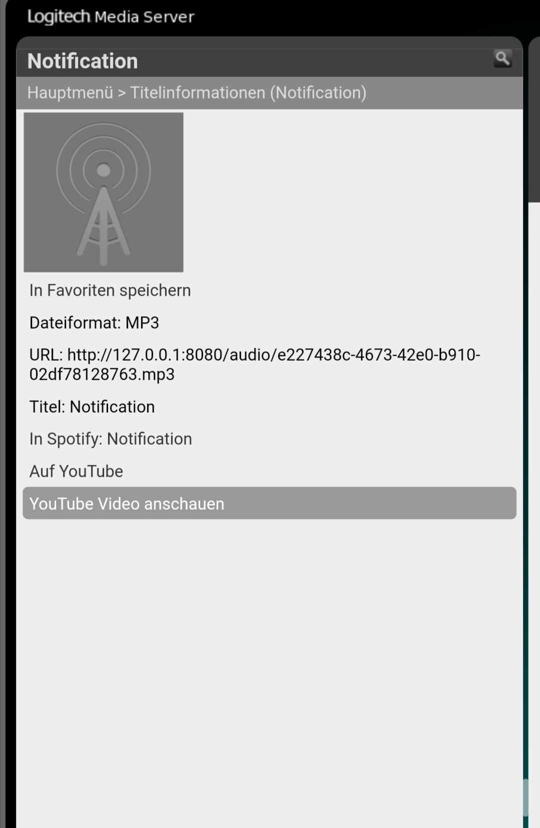

No that suits … The fully active directory /// … But where is the folder: 8080 / audio … In the ubuntu directory?

The openHAB web server is what serves the audio content from http://:8080/audio/…
I also have the LMS on the same host that runs openHAB.
For example, when I play a file from conf/sounds using smarthome:audio play barking.mp3 from the karaf console, this is what the binding sends to the LMS.
2019-10-09 13:44:52.653 [DEBUG] [rnal.handler.SqueezeBoxServerHandler] - Sending command: b8:27:eb:16:3f:1e playlist add http://192.168.1.31:8080/audio/1d3f1ebb-794c-4e4e-8e1d-e261e3e5df0d.mp3 Notification

I have no idea what is to do… No sound… CLI INTERFACE works
Is the 8080/audio directory…the same /etc/openhab2/sounds…?

No. The openHAB internal http server exposes /audio/<filename>.mp3, which is what it uses to deliver the audio content (in this case, the contents of the mp3 file in conf/sounds) to external clients.
Try putting the actual IP address back into the squeeze server config (I think the openHAB web server only listens on the interface associated with its physical IP address). Also, if you configured the callback in the binding config, put that back to the default.
