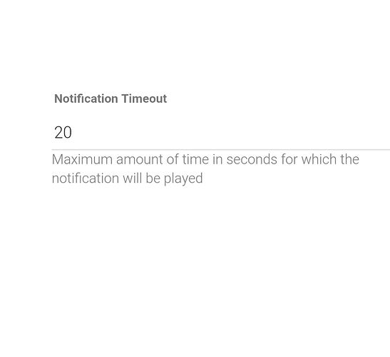

This also can happen if the duration of the content is longer than the timeout set in the player thing configuration. @Marc.pol What’s the duration of the mp3 file you’re playing?
mhilbush
(Mark)
October 8, 2019, 2:23pm
16
Ok, if the content is 15 seconds it’s not timing out because the content is longer than the timeout parameter.
