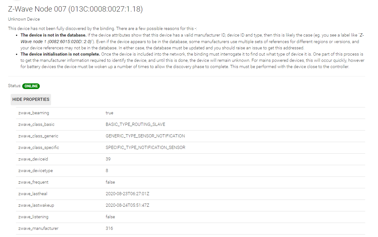

When I add a device, I see
and there is no items to link
Ok, so the device must be added to the database.
To do this you’ll need to follow the instructions as @sihui already provided, or post the XML, as @sihui also mentioned :wink:

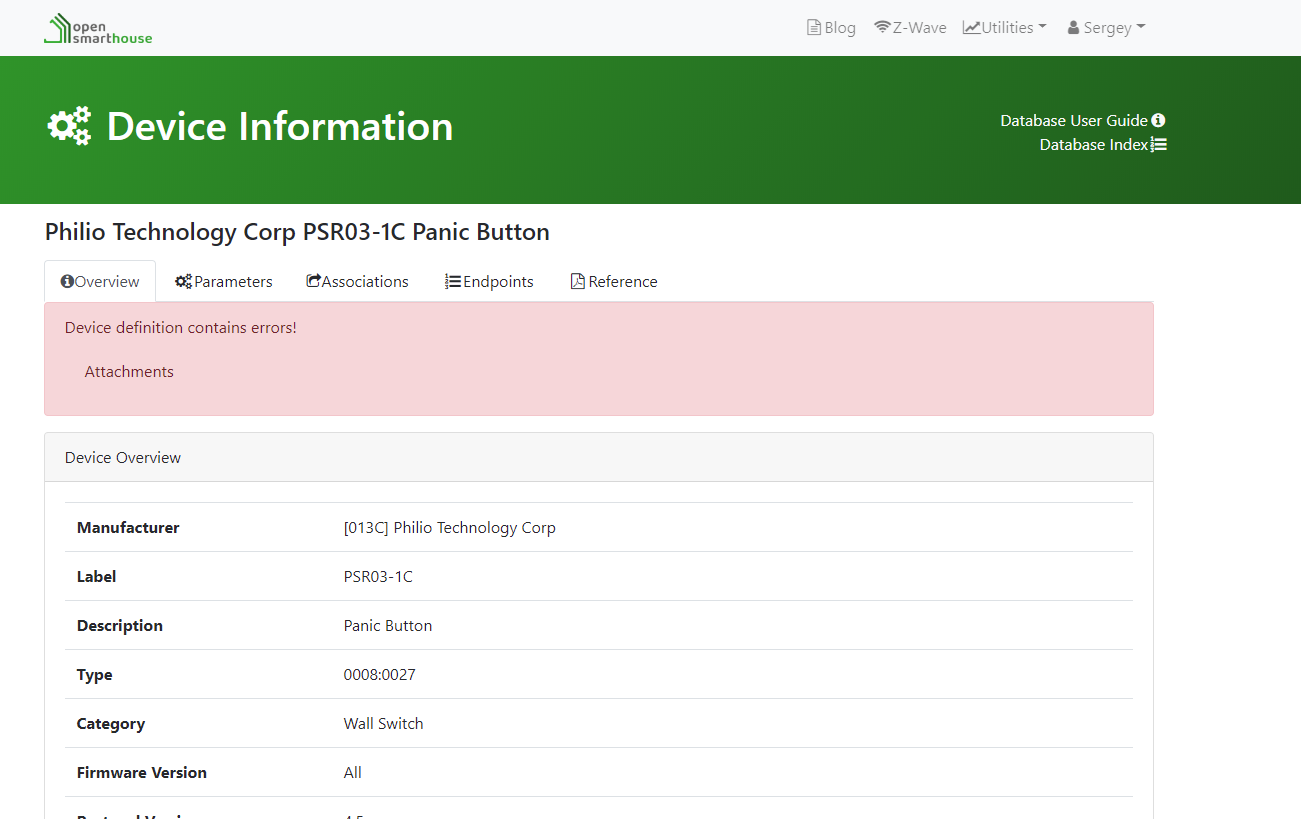

I’ve created the device here. It will require some work to provide all the data - if you can do this it would be appreciated.
Where is Edit button?
As per the instructions, first you need to register for an account, then open a ticket so we can give you edit rights. As much as I’d love to just make the system completely open, the internet is full of people who delight in just messing things up :slight_smile:
Ok, i see
Ok, i have added device (OpenSmartHouse Z-Wave Device Database)
