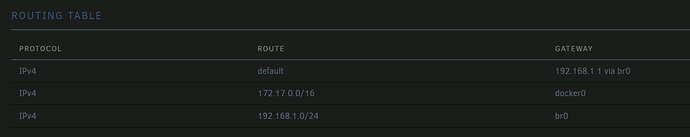

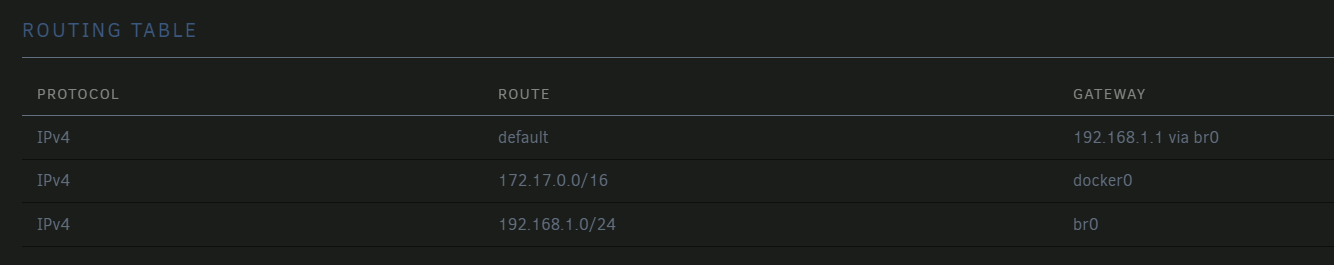

Docker can sometimes be setup where the IP is more like NAT. For example, my dockers all sit on a 172.17.0.0/16 and the LAN side is basically NAT’ed through.
Is this what you have?

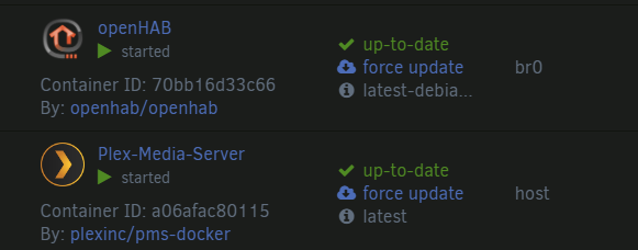

I am starting to think you are on to something since my OH Docker runs a custom br0 network
Similar yes, mine run on a synology. You may need to add that 172 network. My plex is on a NUC, my OH is in a docker.

This is what the docker setup looks like right now:

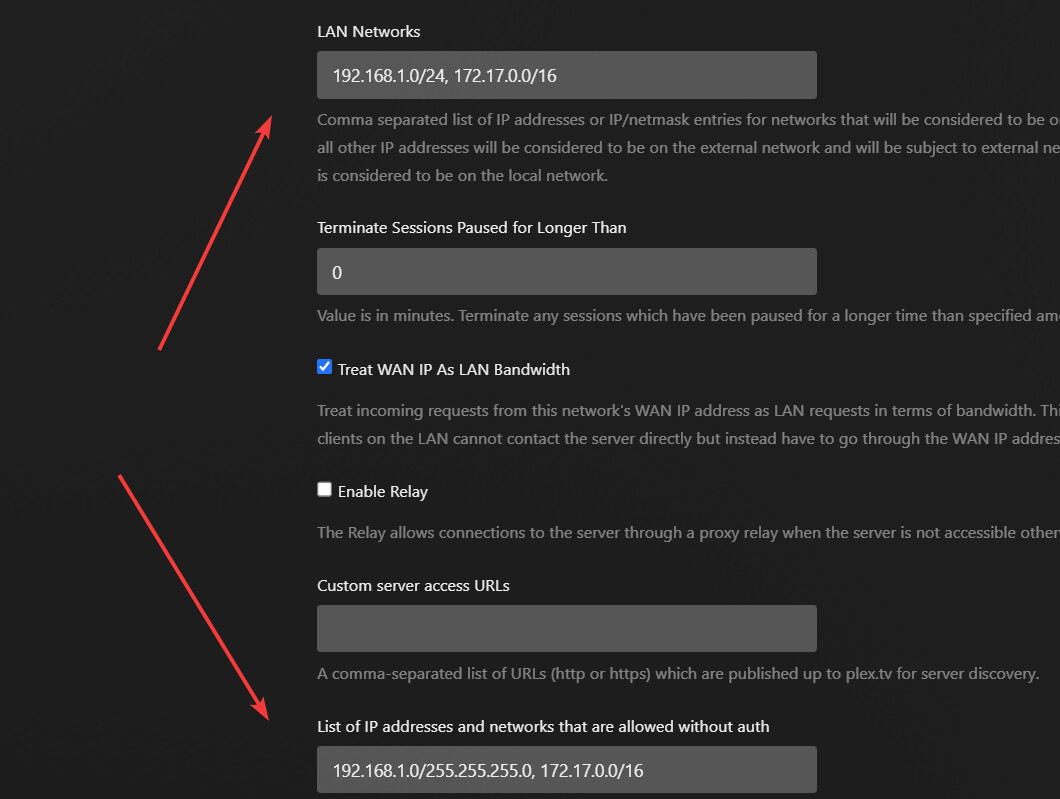

I was meaning here on the plex. You may need to specify the 172 block as an additional LAN network.
Like this?
I would give that a try to see if it fixes it.

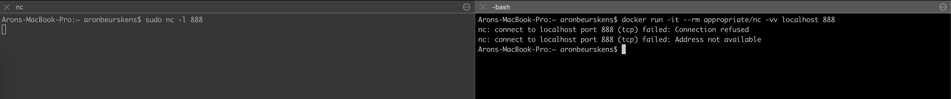

I don’t think the docker container would be able to connect to the host that way. Normally a docker containers network is limited. Did it work in the past this way?

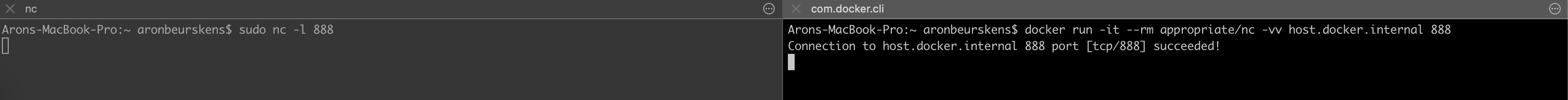

When I test with some simple docker/nc configuration:
This shows it is not able to connect. However if you use host.docker.internal instead of the hosts real ip it translates to the internal ip adres of the host used in docker and then the connection works.
So in this case I would suggest that you change the IP address of the Plex Server in OpenHAB to host.docker.internal. And of course add the Authentication Token as well.

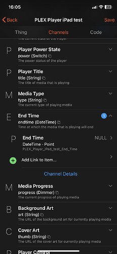

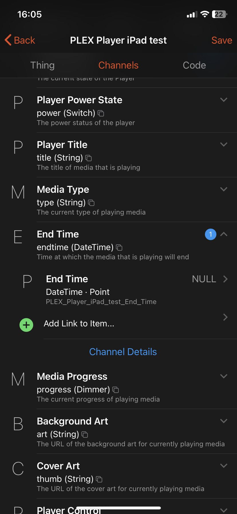

Hey everyone, can I bother you guys for a quick test? I’m trying out the plex binding on v4.0.1 and I noticed that the end time channel stays null.
I tried with both a browser and an iOS app, and neither seem to populate it correctly. Anyone else seeing the same??
The logs don’t seem to receive anything about the end time at all.
