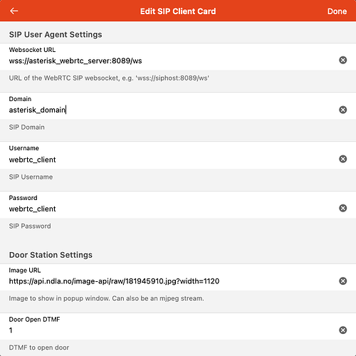

I created a new “SIP client widget”, which lazy loads the JavaScript SIP client library jssip. The widget can be configured as usual and allows setting the required SIP credentials.
To use it, you simply put it on the main page that is usually shown on your tablet. Currently it shows a door icon and a dot indicating the SIP status (red=disconnected, orange=connected but unregistered, green=registered).
When a call comes in, a (fullscreen) popup is opened showing an image - which is meant to be a “live” mjpeg image from the front door - and the tablet rings. After accepting the “call” you can send a DTMF sequence to open the door lock.
See some screenshots below.
SIP Settings:
Incoming call from front door (with fake image):
