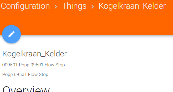

Damned, some updates, and ex-/includes laters, no luck?
Bundle version:
276 | Active   |  80 | 2.5.0.201906161432     | openHAB Add-ons :: Bundles :: ZWave Binding
Thing:
### Z-Wave Node 086: 012501 Electric Strike Lock Control
Any suggestion?

Yezzz, it’s in! Thank you very much!
Next week they expect a heat wave in Belgium, so just in time to open the water from my lazy chair. :wink:
On/Off works fine.
