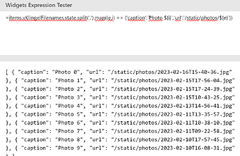

  2. Justin solutions works great (if I replace the @-operator) in the expression tester
    see here:
    but for some reason it does not work in the widget
actionPhotos: =items.vKlingelFilenames.state.split(',').map((e,i) => {'caption':`Photo ${i}`,'url':`/static/photos/${e}`})

after some more testing: the @-operator works like this:
=@@'vKlingelFilenames'.split(',')
but .map in combination with @-operater does not work
EDIT2: Hold on, it does not work in the widget editor but when launching a page containing the widget it works perfectly
