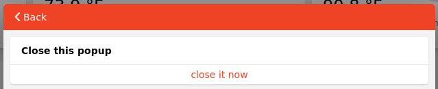

If a card on a page uses this as it’s popup:
- component: oh-grid-col
  config: {}
    default:
      - component: oh-label-card
          action: popup
          actionModal: widget:demo:close_ui_popup
          label: Open the close popup
Then clicking on the label card will open:
and clicking on the close it now button closes the popup again.
