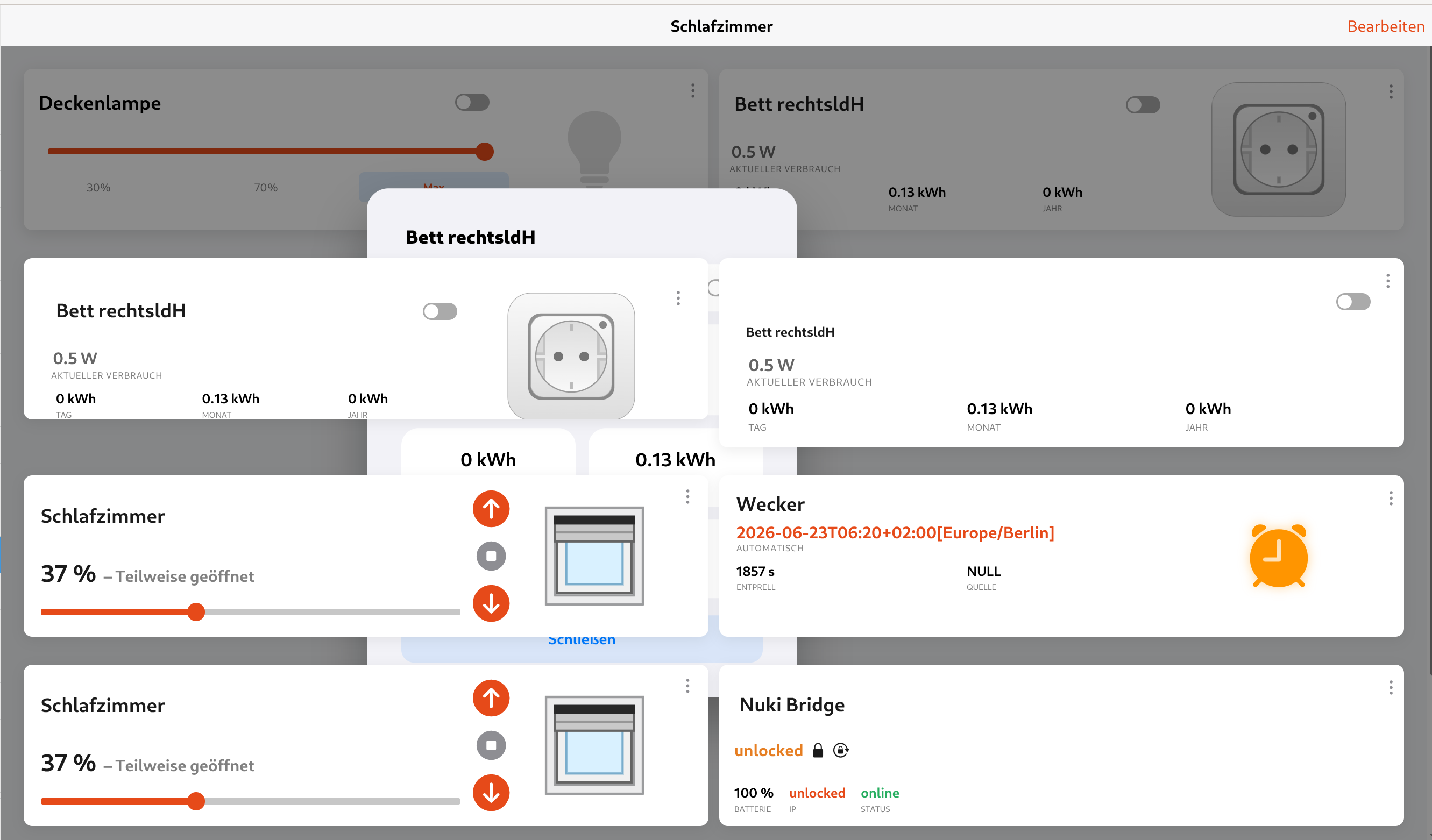

Position: fixed popup inside widget gets visually "trapped" behind other grid cards – z-index/stacking-context issue
Hi all,
I’m building a custom widget (Cell_Plug_Card_Statistik_expone_BoldHeader) for an outlet card with consumption stats. Clicking the “…” menu opens a detail popup that uses position: fixed to center itself over the whole page (backdrop + layer).
Problem: The popup does open, but it visually renders behind / between the other cards in the grid instead of appearing on top of everything — see the attached screenshot. You can see the “Wecker” and “Nuki Bridge” cards, as well as parts of the rollershutter cards, layered over my popup, even though I’m setting z-index: 9998 / 9999 and position: fixed.
My guess: a parent component in the grid (the f7-card with overflow: hidden, or the grid cell itself) creates its own stacking/containing context, which makes position: fixed resolve relative to that card instead of the viewport. That would explain why the popup only floats “locally” above its own card cell and gets visually covered by sibling cards in the grid instead of sitting globally on top.
Has anyone successfully implemented the pattern “build the expand-popup directly inside the widget” (instead of using f7-popup)? Specifically:
  1. Is there a reliable way to “teleport” an element to document.body from inside a MainUI widget (a portal pattern), so that position: fixed is guaranteed to be relative to the viewport?
  2. Or is oh-popup-card / f7-popup the only robust approach, and custom position: fixed layers inside regular cards are fundamentally unreliable because of grid/card stacking contexts?
  3. If anyone has a working workaround (e.g. an oh-context flag that renders a separate top-level widget) — what does that look like?

Screenshot is attached. Thanks in advance for any pointers!
I’m confused. Why are you trying to build an entirely new popup system when both the OH action: popup and f7-popup already do exactly what you want which is render the popup in the middle of the screen? Can you articulate what it is about the basic system that didn’t fit your needs?
Everything you are doing here is fighting against how the F7 system works. You’re not even “re-inventing the wheel” as the English saying goes. This kinda of looks to me like the equivalent of buying a standard transmission car and then filling the entire passenger seat with a homemade mechanism to press the clutch and move the gear shift automatically.
I’m not even sure I understand the question. f7-popup is the way you build the popup inside a widget. If you mean “Is there a way to build an entirely new, from scratch popup system that functions separately from the F7 system?” Then the answer is, “Not without some javascript and although that’s technically feasible with the widget system, you would waste months doing so and be operating well outside the widget system’s design parameters.”
I have to ask: is this widget code AI generated or AI assisted? It is over-engineered to an extent that I’m not sure I’ve ever seen before. I think a good rule of thumb to apply here is: “if it seems that your widget needs to rely on custom container queries then something has gone wrong”.
My advice here would probably be start fresh. List as precisely as you can the specific design goals of your widget (both functional and stylistic) and from there you can decide whether it makes more sense to use the OH modal action or the f7-popup to achieve your goals. I use both those options in different situations depending on need.
I tried to achieve that a popup is coming directly in the middle and fading in …an f7- expandable card is not the way to go due to the issues earlier what I had…but yeah I guess I need to step back one step and do it again :slight_smile:
This gets you most of the way there:

Animate false is a built-in F7 popup property that disables the fly in from the bottom animation. The fade in just requires having an initial opacity of 0 and a transition effect. The only wrinkle there is that you have to manually add in that the opacity is 1 again when the popup is shown (that’s the stylesheet).
Also fading out would be more difficult as that is also dependent on the backdrop, I believe.
I can pretty much guarantee that the answer is yes and yes, given that I’ve had previous experience with the same user, which lead to this:
