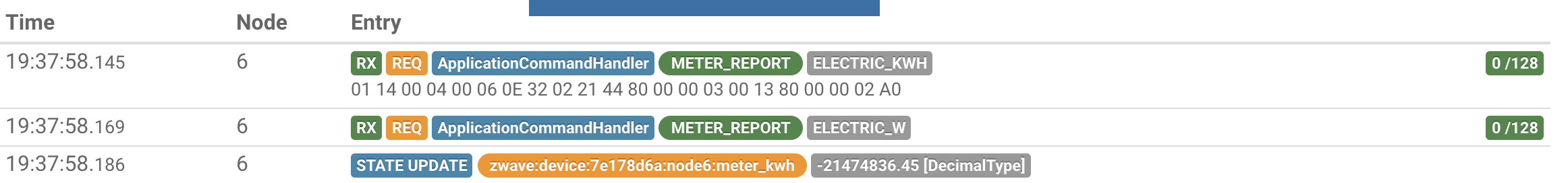

Then, when measurement should be changed, it can be valid or again broken, without any dependency or stable order.
Is this an issue with device itself or somehow connected with binding?
Does anybody also have such problem?
Used version: OH 2.5.0 release.
Reproduced on z-wave binding versions 2.5.0 and 2.5.1.201912260340
So, each second report has right value, but with wrongly set MSB in first byte in report value (f.e., 80 00 00 03).
I think, it’s an issue of device itself.
I have the same issues for sure and many people report it.
