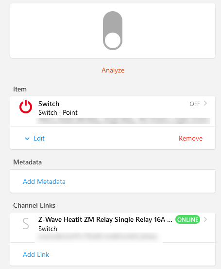

If I press the wall switch (physically), the state of the widget gets updated in OH.
I wanted to trigger the lights by using the OH GUI, independently from the rule set with the Astro binding. I checked the values both sunset and sunrise and both were updated with today’s values.
This is what I got when I used the widget to try to operate the lights remotely with OH GUI.

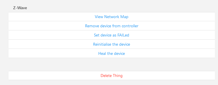

That said there does appear to be a communication issue. If you have five lines on the Node3 UI page you could try the Heal and or the reinitialize options to see if that helps
If you don’t have five lines the device did not initialize after an OH restart and there could be something else wrong.

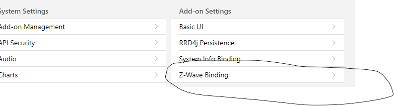

I tried to check the Z-Wave Binding with the circle to change the log level, but did not find it. Could you please confirm which menus I have to click to get to it?

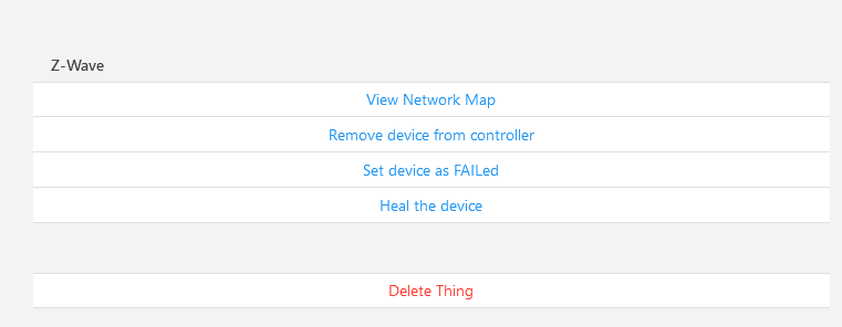

Then I tried a “Heal the device” and this is what I got…
Then the device went OFFLINE (I guess this was normal).
It is now back ONLINE but stillt he same issue.
TBH I do not recall when that was added to OH UI. It should be Settings, go to the right side of the page, Addons, Zwave (should be a list of all your addons), then click on zwave and change to log level as needed.
If you do not have that, you have to SSH into karaf (openhab-cli console) and use log:set debug org.openhab.binding.zwave

Thanks a lot for your indications. I got it now.

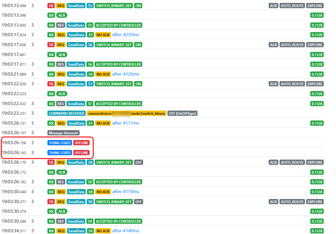

I was able to set the debug mode and triggered the operations. :slightly_smiling_face:
Looks like the device went offline when I requested the operation. :expressionless:
The only other red items are the TX ones you mentioned.

Anyway prior to the OFFLINE, I see 3 tries to turn the light on and they all timed out due to the device not acknowledging the message so there is some communication problem. Not sure what since the HEAL seemed to work (HEAL deletes all the old routes between the controller and the device, then reestablishes them.)
You could try the reinitialize option on the UI (if you are back to 5 lines) while in debug. It will be a large file, but the viewer will color code (REINITIALIZE reinterviews the device like during inclusion). My guess (and it is only that) is something is amiss SWITCH_BINARY command class.
