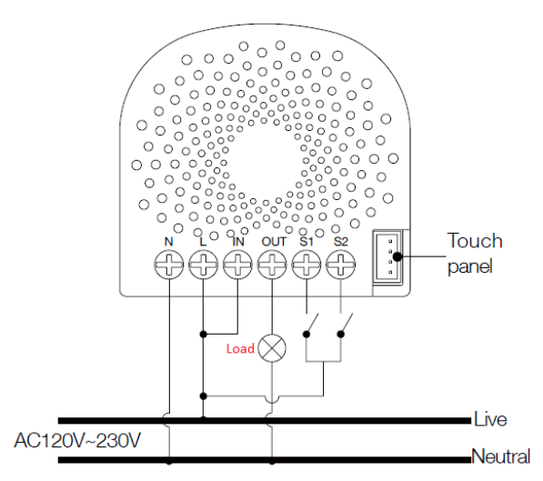

As an alternative to a “no neutral” switch I can recommend the Aeotec Nano Switch which is what I use. (N.B. I have not tested it with openHAB yet)
It is basically a z-wave relay that can be connected to an external switch for manual control.
I put it behind my light fitting (instead of behind the switch as they show in their instructions) and it was as simple as:
  • Connect L/N to permanent L/N.
  • Connect In to L
  • Connect Out to the light fitting where the switched line used to go.
  • Connect S1 to one of the wires coming from the switch.
  • Connect other wire from the switch to L.
The existing light switch will continue to act like it normally does so will not need to be replaced by a z-wave switch.
