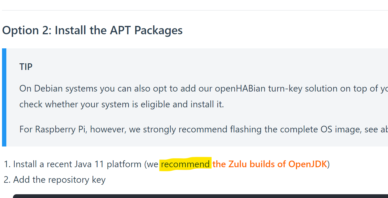

The online documentation seems to indicate that zulu is the default option, which it appears to not be so, and that zulu is the preferred runtime. Is there a definitive answer on this now in 2022? And if so is there any real reason to switch to zulu?

Where exactly did you see that ?

The reference I was seeing is in the prerequisites section of the installation overview page

Maybe I don’t understand “rntime”, but Zulu is still the recommended Java to install according to the openHAB docs, as @pleedell pointed out.
Zulu is currently the recommended Java platform for openHAB.
OpenJDK may also be used, but it has some known limitations with openHAB and is not recommended.
(Irrelevant, of course, when talking about openhabian)
also on the download site zulu is recomended
Although related to the latest versions I regard recommendations for Zulu as outdated.
I thought that section of the docs changed some time ago. Neither openHABian not the Docker image use Zulu any more I think
The docs may need to be updated.
I’ve submitted a docs PR for that.
Someone else please do for the download site.
