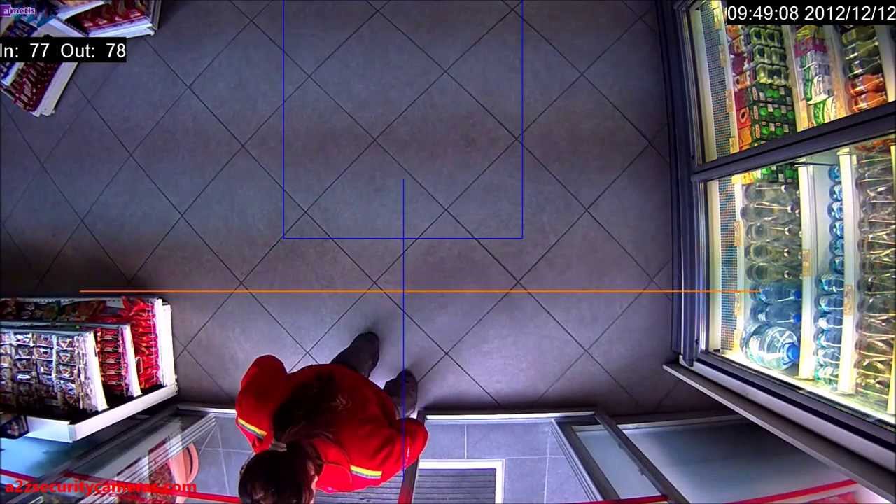

But, a camera above entrance could work like this I think

I’ve been involved with a couple of projects that use this technology (for people counting) but with an managed service - not with OH.
There are cameras specifically designed for this purpose and they work extremely well in detecting people and being able to differentiate between pets and humans if needed.
Take a look at the camera products from:
Axis - Axis people and vehicle counting solutions | Optimize flow
Vivotek - https://www.vivotek.com/website/sc8131/#views:view=jplist-grid-view
Acti - Products | ACTi Corporation
Good luck and please report back your findings.
