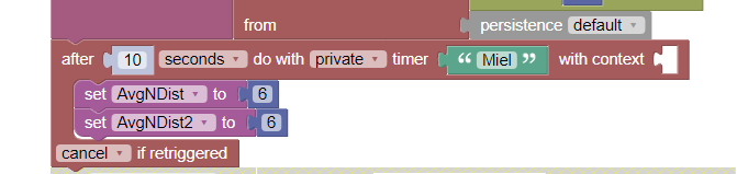

thanks both, this is how I solved it right now:
I take the average distance of the past 10 secs in 2 variables (AvgNDist and AvgNDist2), these variables are used to calculate the Home or Away status.
The timer runs for 10 sec, if it’s not retrgitriggered within the 10secs, than there’s obviously no update in distance and I set both variables to 6 (out of range). If the timer is retriggered, I cancel it.
