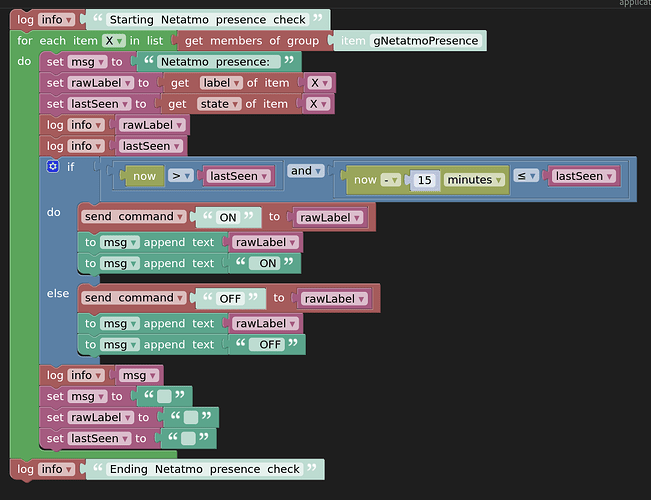

For each channel from the group, if current time is between «last seen» timestamp and «last seen» timestamp + 15 min, the person is considered to be at home. The switch is set to “ON”.
All «log info» can be removed (it is only for debugging!)
This looks like a good candidate for a rule template. See How to write a rule template. You’ve figured out the hard part so all that’s left is a minor formatting change and adding some properties (e.g. set the Items and the timeout based on a property instead of hard codeing.
Even for Blockly, the best way to share a rule, if you don’t do a rule template, is to click on the “Code” tab and paste the text you see there into the post using code fences.
code goes here
Definitely post a screen shot of the blocks too, but with the actual code the rule can be copied and pasted instead of recreated from scratch. A rule template is even better since the user can install it like a binding and configure it like a Thing.

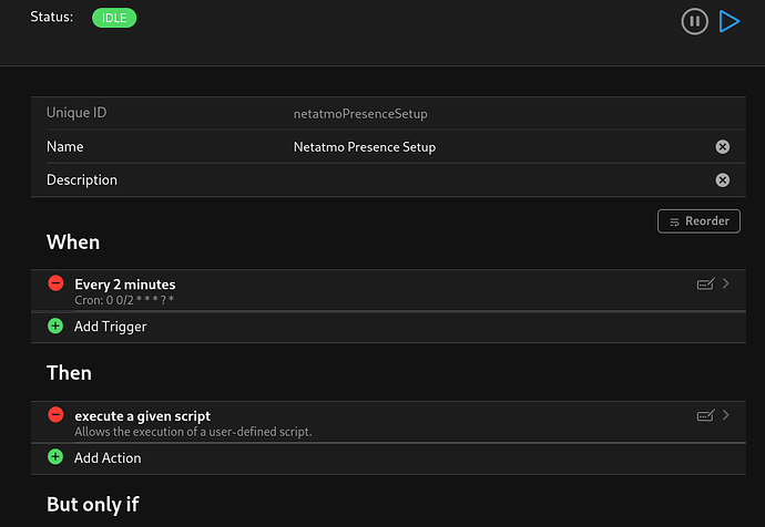

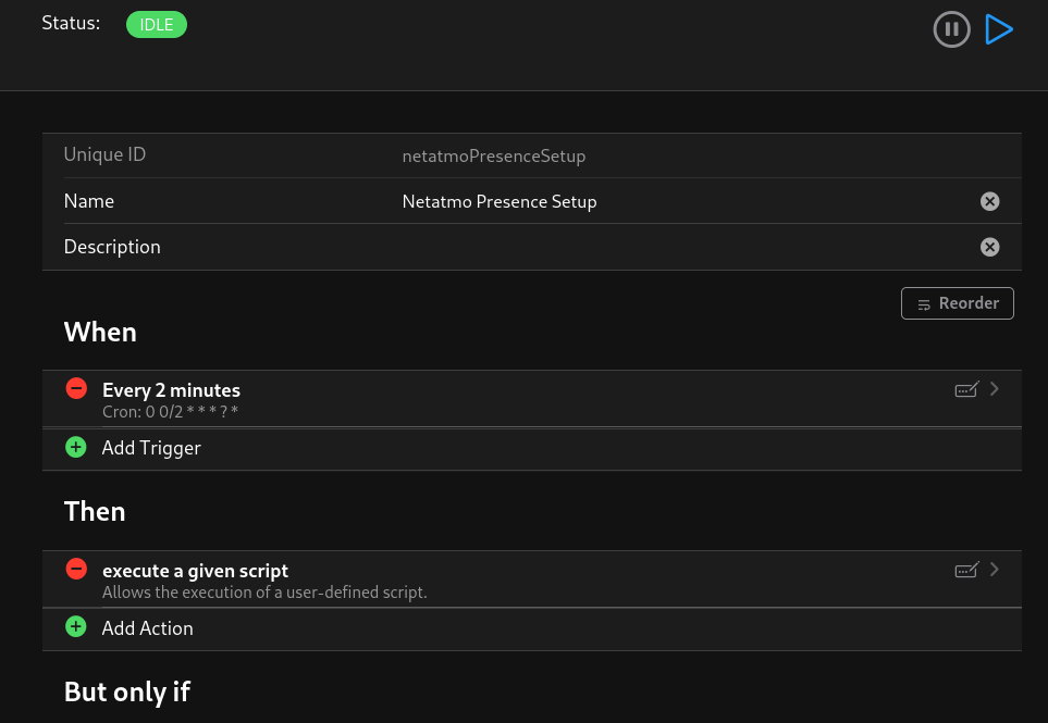

Ok, I forgot that there are two “code” tabs. You’ll want to back out from the script action to the main page for the rule that shows the actions, triggers, and conditions and post the contents of the code l tab from there so that the entire time is captured.
The code you posted above is just showing the JavaScript that your Blockly “compiles” into. But I suspect you really want to show the entire rule.
