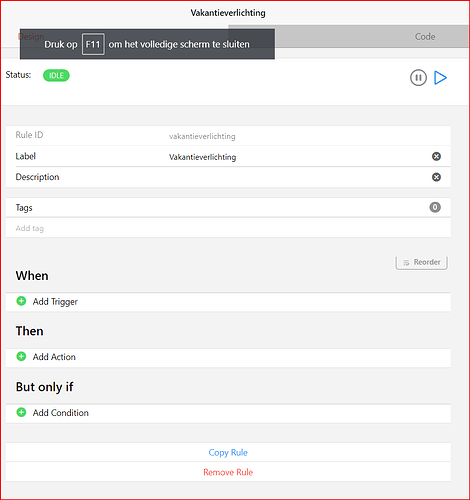

I think I created a rule based on the template, but I’m not sure…
First oddity: when I wanted to select ON or OFF for Enable Simulation, I was only offered a list of items, not the choice between ON or OFF:
(So I didn’t select anything.)
Second oddity: where are al the specifics stored/visible?
configuration:
  simItems: vakantieverlichtinggroep
  days: 3
triggers: []
conditions: []
actions: []
Also, when I run the rule manually, nothing logs.

That indicates the rule didn’t get instantiated correctly. Once a rule is created from a template it’s a rule just like any other.

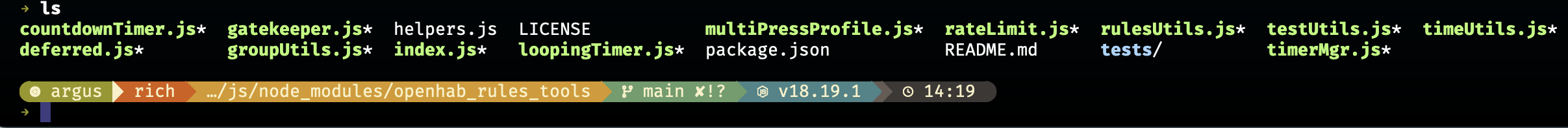

  1. create the folder $OH_CONF/automation/js/node_modules/openhab_rules_tools
  2. download the latest release from Releases · rkoshak/openhab-rules-tools · GitHub (zip or tgz are the same)
  3. extract the code from the zip file to $OH_CONF/automation/js/node_modules/openhab_rules_tools. It should look like this:
Make sure it didn’t extract to a subfolder or something like that.
Note with this approach you will not get updates. You’ll have to manage the library updates on your own.
