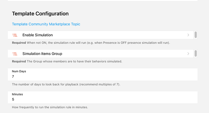

Parameter Type Purpose
Enable Simulation Switch Item Switch Item which, when OFF, will trigger the simulator rule to run. OFF was chosen to make it easier to tie the rule to an Item that tracks presence.
Simulation Items Group Group Item Group whose members are those Items that should be included in the presence simulation. All these Items must support commands (e.g. no Contact Items) and their states must be saved by the default persistence (e.g. no String Items if using rrd4j).
Num Days integer The number of days in the past to simulate the behavior from. It’s best to choose a multiple of 7 to correctly capture different behaviors between work days and weekends.
Minutes integer How many minutes between runs of the rule.

@rlkoshak : maybe this a stupid question: How are the parameters setup and initialised in the UI?
As with all rule templates:
  1. Navigate to Settings → Automation
  2. Select the rule template to install and click “add”
  3. Navigate to Settings → Rules and click + to create a new rule
  4. Choose the rule template to base the rule off of
  5. Fill in the parameters
