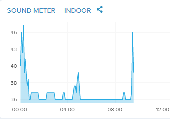

  4. Noise control Everytime noise level above 40dB detected send Presence_Home.sendCommand(ON) Nice when watching a movie!

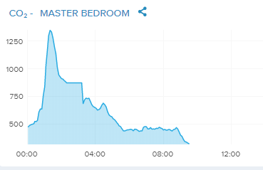

  5. CO2 level Everytime CO2 level is above 500ppm send Presence_Home.sendCommand(ON) Only way to detect that someone is sleeping as far as I know..

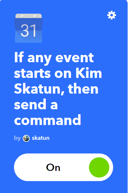

  2. Holiday mode Then I also have our calendar events, when this gets triggered I checked if presence is off and if so I activate holiday mode. (It happens that weekends trips get cancel and I forget to update my calendar :slight_smile: )

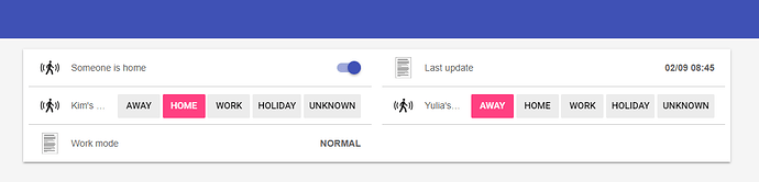

So this works pretty sweet for me.. I currently have no need to know that I am in a certain room. This is how it looks like:

rule "Noise Level"
    Item Netatmo_Indoor_Noise received update
    if (Netatmo_Indoor_Noise.state>35.0){

Do you have the dog in the bedroom? Also maybe you can set the trigger level higher then 500 to eliminate your dog…
Thanks for the nice tutorials, I would like to ask a non-presence-related question for your CO2 sensor
why your co2 sensor goes that high?(I can see it’s higher than 1250ppm), do you use some products to detect human breathing? and may I ask you what product do you use? This is because I have a co2 sensor and it always around 60-180 reading, I never get that high reading(>250) except someone is smoking:) in the room. and why dectect “human-breathing”? I mean, isn’t this type of sensor is always used to detect smoke(like in the kitchen)?
Are you sure you use CO2 sensor and not CO sensor, I use Netatmo sensors, but I know iteead have CO2 sensors as well.

The dog has the full run of the house except the room where the cat’s food and litter box lives. We only have a welsh corgi who is around 30 lbs (13.6 Kg) so I doubt that she would would raise it much. But I have many friends and aquaintances with quite large dogs and I would expect them to trigger the CO2 level as many are the same weight as an adult human.
I’ve also two cats who combined might be enough to trigger the CO2.
But my main point is that everyone needs to look at their unique situation and choose sensors that make sense for their family. Often dealing with pets is something that gets forgotten until the cat starts triggering the intrusion alarm in the middle of the night because the PIRs are too sensitive.
