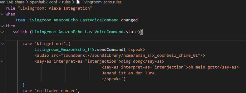

But while playing around, I had a significant delay like 30secs between saying something and the response of her saying something back using TTS. The log changed instantly, I was just “hearing” her response much later. It is replicable:
I edit rule-file.
Then I say something:
than no response..
until 22:25:10 - nothing in the logs, but alexa starts with that chime and starts talking “ding dong”..
So I didn’t change the file.. and asked her the same thing again, quick response. then I ask her again, quick response. Then I ask her again, 2min break before the response.
I know that behavior from the past, like a spam-blocker, because I ask her the same thing multiple times..Like there is a “only 5 TTS per minute or so”..
I have trace-logs enabled, no entry of “many”(requests).

Hi Trinitus,
that made it worse. Now, the delay is everytime.
If I say klingel mal, she will responde about 10-20 sec later.

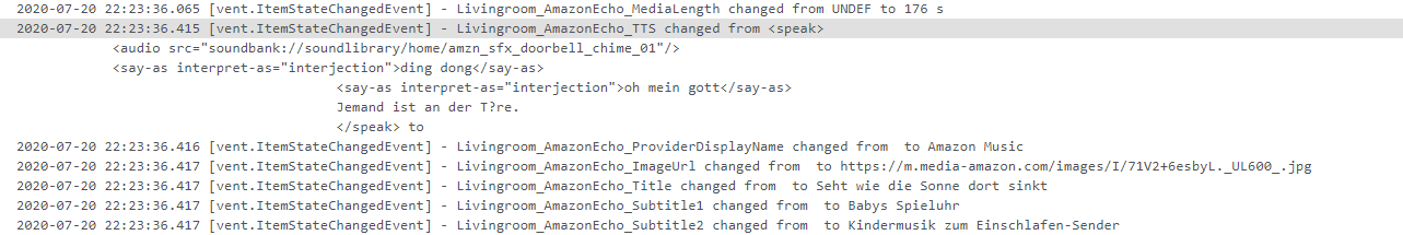

And I see
2020-07-21 21:11:59.968 [vent.ItemStateChangedEvent] - Livingroom_AmazonEcho_LastVoiceCommand changed from <speak>
                <audio src="soundbank://soundlibrary/home/amzn_sfx_doorbell_chime_01"/>
                <say-as interpret-as="interjection">ding dong</say-as>
                <break time="100ms"/>
                <say-as interpret-as="interjection">dang</say-as>
                Jemand ist an der T?re.
               </speak> to
2020-07-21 21:11:59.968 [vent.ItemStateChangedEvent] - Livingroom_AmazonEcho_LastVoiceCommand changed from  to klingel mal
2020-07-21 21:11:59.980 [ome.event.ItemCommandEvent] - Item 'Livingroom_AmazonEcho_LastVoiceCommand' received command <speak>

The logs are doubled? It is only talking once, but the logs show 2 entries each.
How can I help? I have trace logs, and I have team viewer :slight_smile:
Played around a little by myself.
I switched from a test routine triggered by voice to a test routine triggered by a switch.
Delay is still there.
And if I do something like:
voice trigger the test routine (my living_room_echo should talk)
switch trigger a different test routine (my living room echo should talk as well)
there is 20sec pause.. then talk.. then 20sec pause again.. then talk
