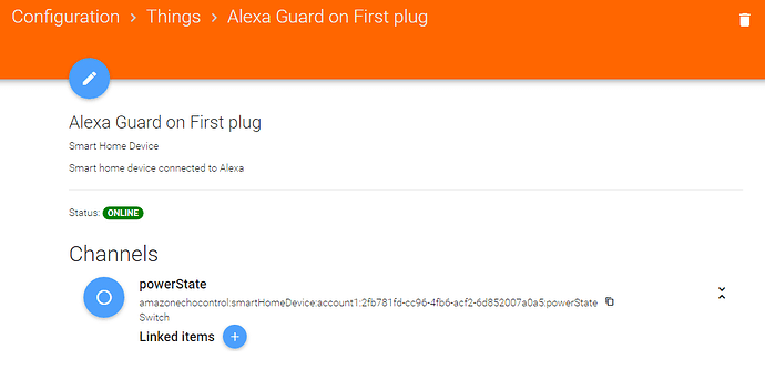

Just deleted and added the account again to the binding, than the echospot was marked online.
I can now also control it via openhab. Its really nice and fast response!

Hi @J-N-K, its a simple switch item. Here is the definition:
Switch Plug_State "Geyser1" { channel="amazonechocontrol:smartHomeDevice:XXXXXXXXXX:YYYYYYYY-YYYY-YYYY-YYYY-YYYYYYYYYYYY:powerState" }
Logs continue to indicate that the state is received

For Amazon ‘first plug’ I created a PaperUI thing but am unable to link and item
Presumably because Alexa guard is not yet available in Austria but more probably because it is not a feature the plug has!

The device I am having trouble with is an amazon plug. It doesn’t do anything other than on and off but it is discovered as Alexa guard!!
Here is what it looks like in the Alexa app
I can create a Thing in paperUI but when I try to link with ‘create a new item’ nothing happens, no link is created and no error in the log at debug level either. The item is created and appears at the very end of the item list, unlinked
The device is a simple plug from Amazon for Alexa
I checked the code and it’s just a misleading label. I’ll add some debug logging to the next release that’ll help getting more information to find the correct label.
The link problem most probably is a PaperUI issue, not related to the amazonechocontrol binding. Can you link to the item after it is created (i.e. not “Create a new item” but “Existing Item”)?
