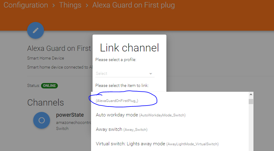

I tried again with paper UI ‘create new item’ but it didn’t link. An item was created and tried to manully link to it and that failed too.
What happens when you try to link to that item?
Nothing happens.
Now I am trying to manually define things and items in the config files but no luck so far. I got the Thing id from discovery and copy and pasted that into my definition but its not working.
edit … Gave up with thing config file and tried to assign a manually created item to Paper UI thing. It does not liink
Switch AFirstPlug "A On/Off" { channel="amazonechocontrol:smartHomeDevice:account1:smartHomeDevice1:powerState" }
And there is no log why this fails?
