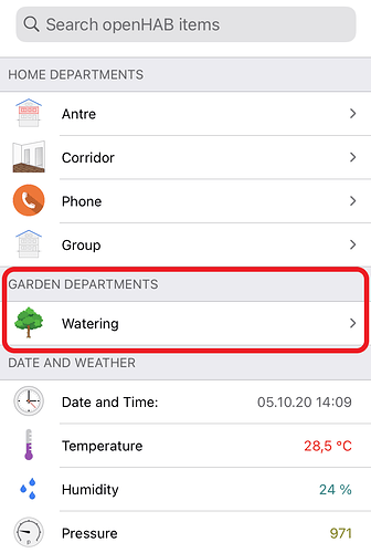

Hello, I have a question, I have a gardener use the section on gardening. But I don’t want him to see information inside the house. Can I provide this I hope I could express myself. Best Regards.

I can check it normally right now. I want to give the garden items to the gardener with the new user and password. Can this be done?

When I give the Gardener a new username and password, I want it to see and use the Section marked in red. I hope OH3 this is what we want.

I want it to see only the red area that I have shown in the picture above and manage its items in that area.
oh ok then you can set the visibility of the parts of the sitemap you don’t want him to see. Then you can have a way to show them when you want to use them like presence detection so when you are home they are showing but when you leave they disappear.

If they are using their own phone, you could create a second Sitemap just for them, and prepare their phone yourself so the new Sitemap loads by default.
It’s not secure because they could try and load the original Sitemap, but there’s not many options with default openHAB 2, and presumably you trust your gardener…
