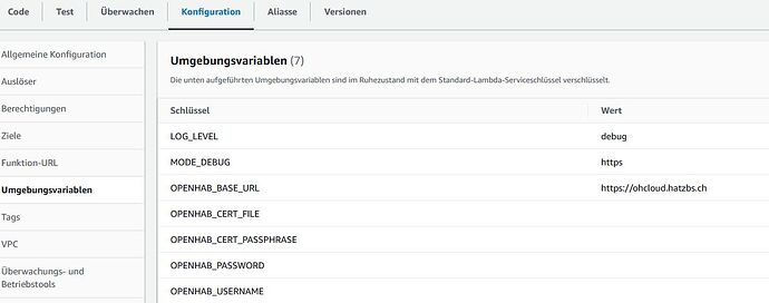

Were you able to confirm your OH base url?
Yes, NODE_DEBUG didn’t change anything
I was looking at all logs of the proxy and could not see any hit
Yes, OH base urls is set correctly
It’s NODE_DEBUG
not MODE_DEBUG
