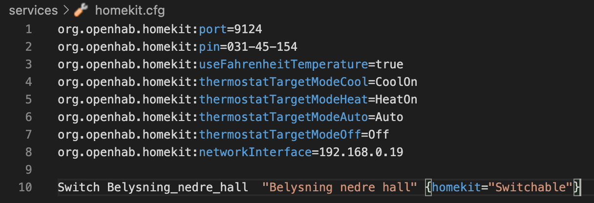

homekit.cfg is wrong place. it has only global, not item related settings. you need to add it to you items configuration.
in my case it is in directory
/etc/openhab2/items/
the file can have any name but should have extensions .items
Thanks, that solved the immediate problem. Only cosmetic issue now it that it is called “Switch 1”. Nothing I have specified. Does anybody know how to get it to use the “Belysning nedre hall” that I have specified in the .items-file?
