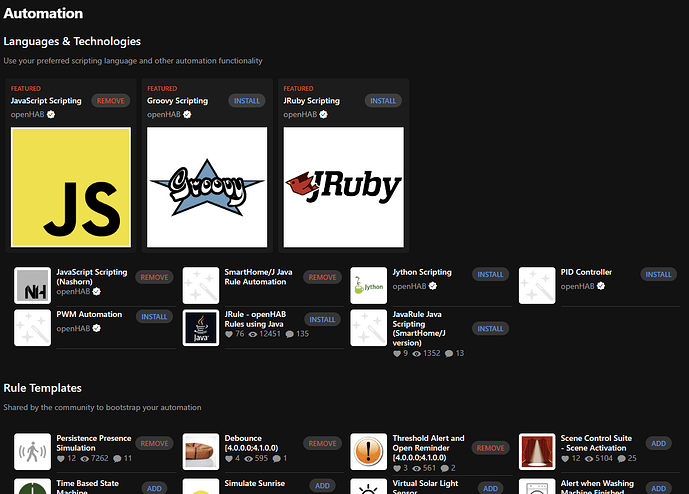

OH4 after upgrade error , seems only to be a startup issue
My javascript is doing a HTTPGet , Iâm not 100% sure but it appears âactionsâ is not initialised
