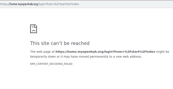

When I click to access my dashboard. I am getting below error,

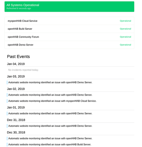

It appears that there are some issues with the cloud server at the moment:
Although it is showing operational there was some problems earlier
An I am offline…

You mean problem is with openHAB cloud service, not with my setup.
I am getting below status…

It’s working for me now and it wasn’t 2 days ago
Ok.. It is never worked for me. I have not connected openhab cloud yet ..

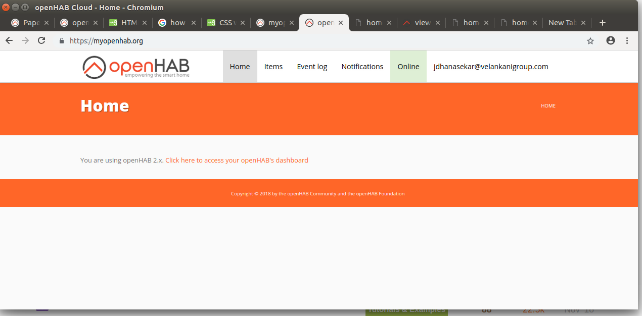

yes.. I can able to go into https://myopenhab.org/
After trying to access openHAB’s dashboard, I am getting the error

I have observed that after setting mtu size to 1472 and then pinging myopenhab.org ping -s 1472 -M do myopenhab.org is throwing error.
Later I tried to decrease the mtu size and found mtu size 1443 is not throwing error. So I set that value to mtu size like this sudo ip link set enp1s0 mtu 1443.
After setting mtu size ,I tried to access OH’s dashboard but I am getting the same error ERR_CONTENT_DECODING_FAILED. Still I am unable access the dashboard.
When I ping myopenhab.org with new set value ping -s 1443 -M do myopenhab.org
, I am getting error.
It seems that assigning what ever working value for mtu size, it is also not working after setting that value.
