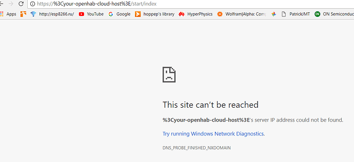

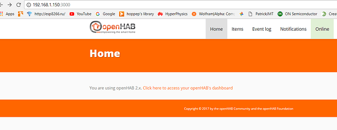

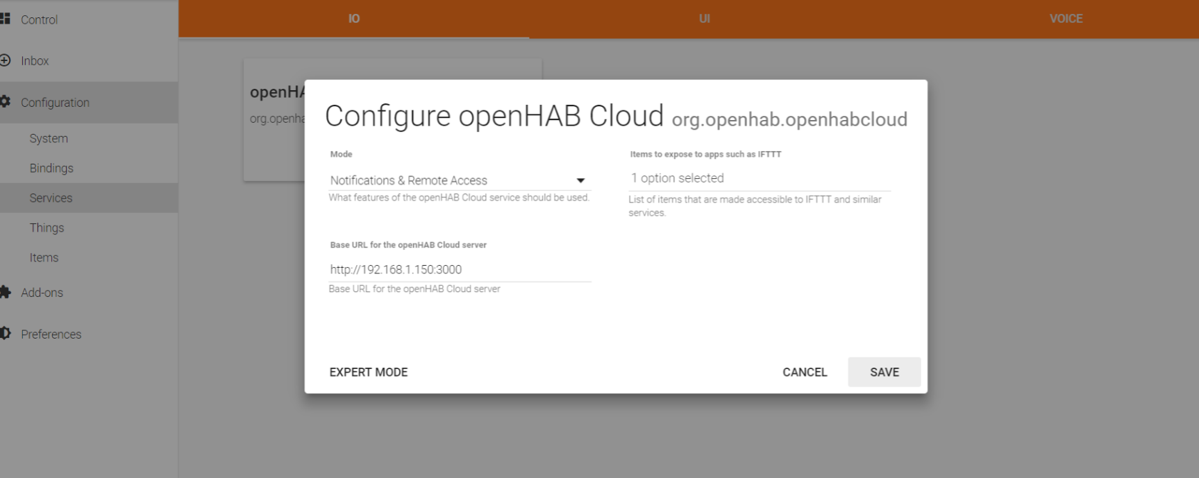

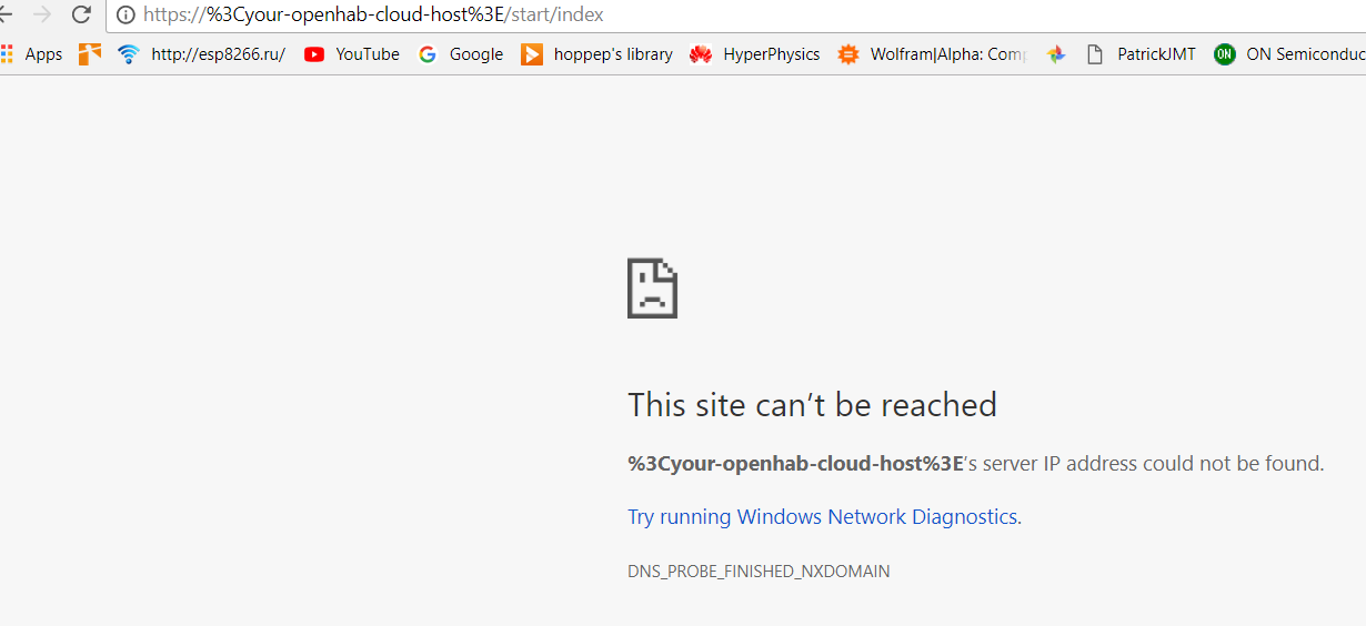

i’ve recently installed myopenhab_cloud and openhab2 platform on my virtual machine Ubuntu distribution, they are working fine, but when I try to access remotely my dashboard i get this error
DNS_PROBE_FINISHED_NXDOMAIN
i’m using chrome webbrowser. look at these images for more clarifications.
  • openhab dashboard.
  • myopenhab_cloud web interface.
  • myopenhab cloud error.
I forgot to set the system parameters
    "system": {
      "host": "<your-openhab-cloud-host>",
      "port": "443",
      "protocol": "https",
      "logging": "info",
      "subDomainCookies": false

So firstly you must rename the file config-production.json as mentioned in this post OpenHab Cloud Installation - #2 by MARZIMA. and next edit your system snippet.
this is my local configuration:
    "system": {
      "host": "192.168.137.246", //you openhab2 installation ip
      "port": "8080", // the 8080 openhab2 installation port
      "protocol": "http",
      "logging": "info",
Don’t forget "registration_enabled": true.

Thanks for your response. I believe I have figured out the correct settings. I believe we need much better documentation of this config file to properly configure openhab-cloud for new users.
I think that the information you’ve provided is actually not the intended use-case. Below is my explanation for how I think this is intended to work:
"system": {
  "host": "<host-name-or-IP-address-of-your-openHAB-cloud-installation", //your openhab-cloud installation IP or hostname
  "port": "8000", // the internet-accessible port which points to your openhab-cloud installation port.
   // for me, this is port 8000. I opened up port 8000 on my router, which points to my local port 8080 in my home network (through my router's software).
  "protocol": "http",
  "logging": "info",
This information seems to be used by openhab-cloud to be able to correctly build it’s own webpage and nginx proxy. The idea is that you’ve already pointed openhab-cloud to your openhab2 installation using the UUID and secret. The openhab cloud connector add-on for openhab2 handles the connection between your openhab2 install and openhab-cloud. You provide the cloud-connector with the IP of your openhab-cloud instance. And then you provide the openhab-cloud instance with the UUID and secret. And now you can login to your openhab-cloud instance and connect to your openhab2 installation without having to expose your openhab2 installation to the internet.
Does this make sense?
