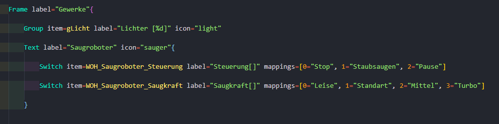

    • If I add an second item to the sitemap, the sitemap crash

This doesn’t work

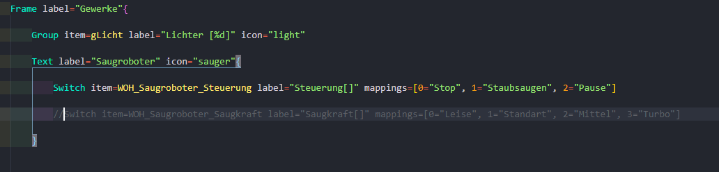

If I “remove” it, I work again.
This only have it with all other items from the vacuum. If I add an other switch for e.g. the lights, I don’t have any issues.
Your sitemap looks normal. What are the [] in the labels for? I didn’t these before. Maybe these cause the errors.
Does adding another item (not miio) work?
in labels are ordinary enough, this is the state presentation formatter, describing how you would like the Item represented in text.
is valid for “no thanks, suppress text” which is ordinary enough when used with a Switch type widget.
I’d be looking at what character set the editor is using, sitemaps need to be UTF-8
