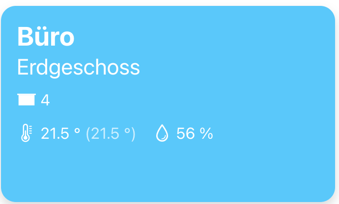

Oddly, there actually seems to be a race condition in OpenHAB:

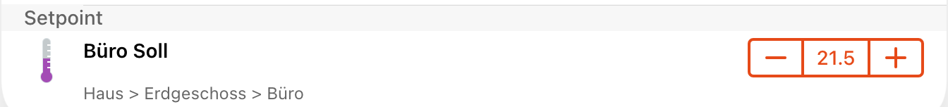

When I first select Locations, then the setpoint is correctly shown as 21.5:

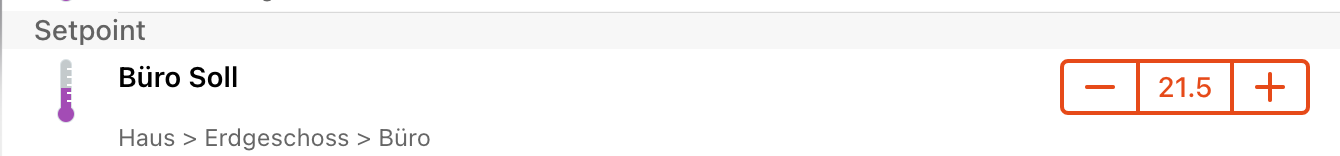

and, interestingly, when I then select Properties → Temperature, it’s also shown correctly:

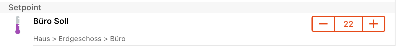

However, if I reload the MainUI and then directly click on Properties → Temperature without first clicking on Locations then it discard the decimal place:

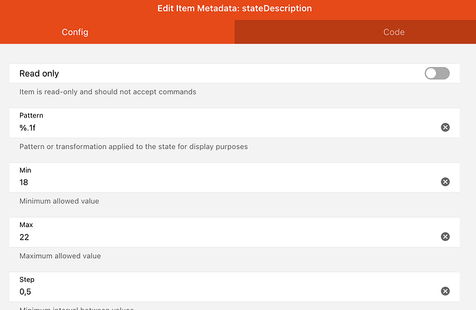

I just updated the stateDescription but that only seems to marginally change things.

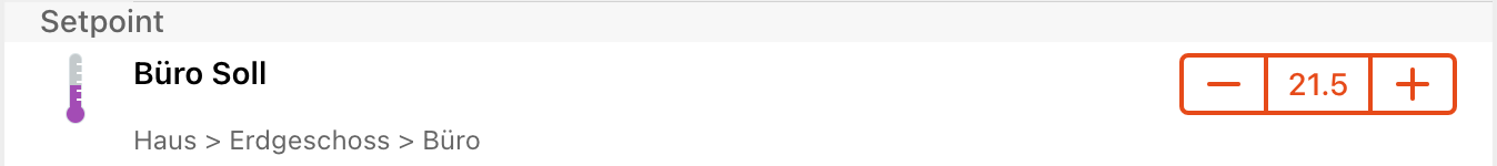

My item config now reads:
Number      BueroSollwert            "Büro Soll" <temperature> (gBuero)                ["Temperature","Setpoint"]       { channel="knx:device:bridge:heating:BueroSollwert", stateDescription=""[pattern="%.1f",min="18",max="22",step="0,5" ] }

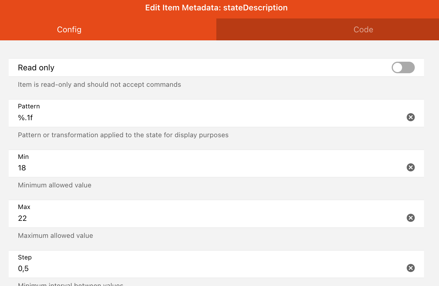

In the UI it looks as:
Now when I set the setpoint to 21.5 and open Properties, it is first shown correctly:

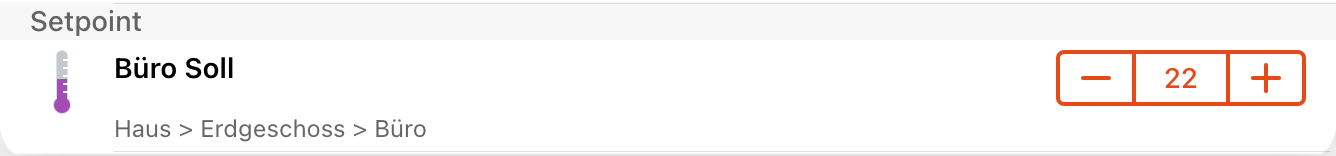

However,, when I then reload the browser tab and click on Properties → Temperature again, then it again shows 22, also setting the Item to that value :frowning:
step="0.5" would be the correct version, I think.
Heureca! Thanks a lot that did the trick!
Sorry that I did not see that earlier! Still, the behavior I saw earlier is kind of strange, though.
