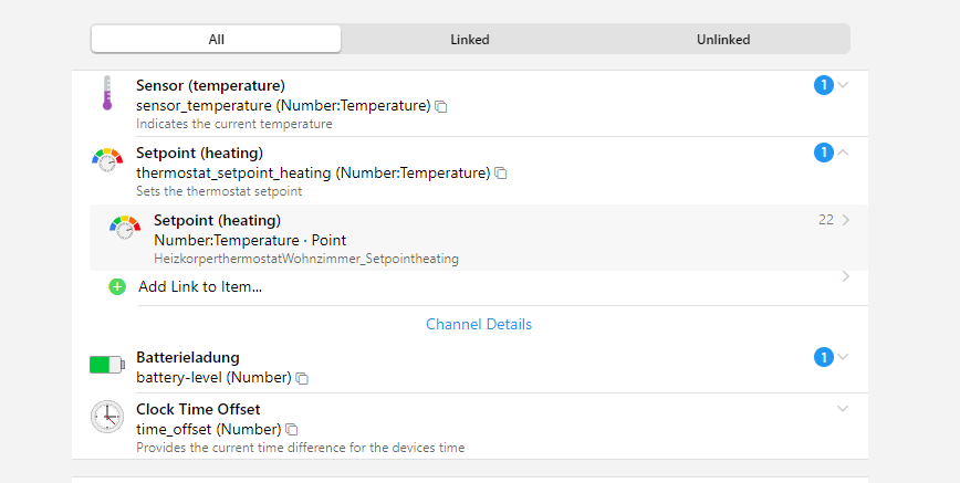

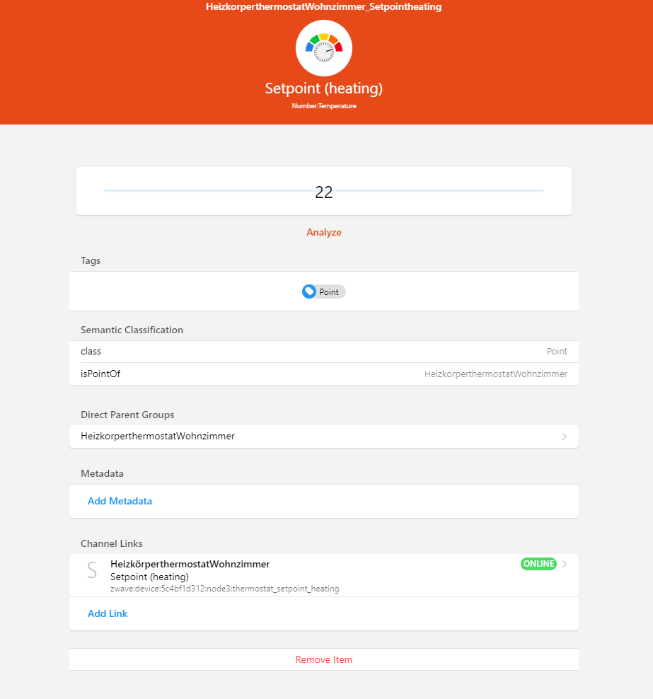

The Problem is that when I set my thermostat to a target temperature of 21.5 C it is set correctly on the Thermostat and in the Habpanel. But it is shown as 22 C everywhere else. This is more an optical Problem, but I want to know if there is a fix for that.
Like I said it shows the Set Point on 22 C. But really it is on 21.5 C
itemlist

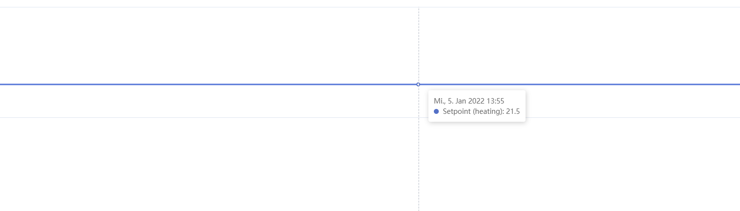

Here its shown correct.

Is the item state actually changing or is it only the presentation of the number in the GUI?
What is the ‘pattern’ in your Item’s metadata?
There was nothing. I added " %.1f °C" and now its working fine. Interestingly the On the Item for the Sensor was also nothing in “Pattern” and it worked fine.
But thank you very much
The item really changed. The Problem was the “Pattern” field in the Item Metadata. Thanks for your Help anyway.
