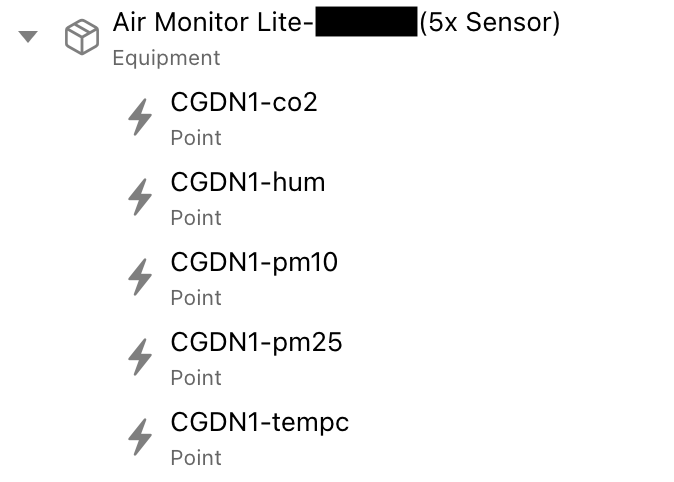

Thanks to your replies I have tested OH 4.3 M4 today, and HA convention MQTT discovery has definitely greatly improved from when I last tested with 4.1.1 (or so). A major step in the right direction!
I tested with the following devices:
  • Qingping Air Monitor Lite
  • Xiaomi CGD1 alarm clock
  • Inkbird TH1 thermometer
  • Xiaomi Mi Band 4
  • Apple Watch
and these are my findings.

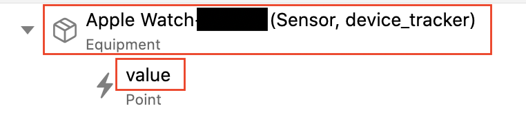

All sensor device class channels are discovered correctly, properly named and display the correct values when a model has been created, e. g. for the Qingping Air Monitor Lite
I didn’t really expect any regression here, as the sensor device class always seemed to have worked, but I am wondering if the HA discovery workaround with having to remove is_defined from the value_template from the HA native version is still required, and if this might possibly also be the null resetting issue @DrRSatzteil is seeing? Waiting for confirmation on his setting of this.
Also the fact that the Semantic Class and Semantic Property are not take over from the discovery messages at all , instead just generally assigning Point to all, would be another point on my wish list for a future slick HA convention discovery.

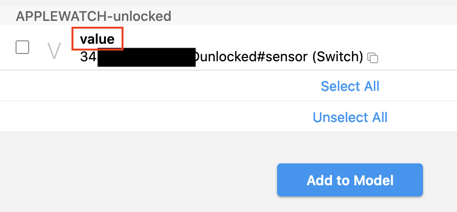

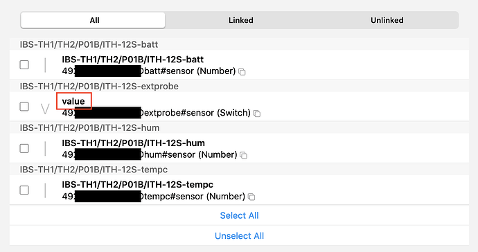

The above mentioned binary_sensor issues seem to have been addressed name wise, but I am seeing a failed NULL binary_sensor for the Inkbird TH1 thermometer, with its discovery message value template being
"val_tpl": "{{ value_json.extprobe }}"
and the MQTT status messages correctly having
… "extprobe": true … or. … "extprobe": true …
making me assume that all other binary_sensors with the same simple value template and boolean values will have the same problem still.

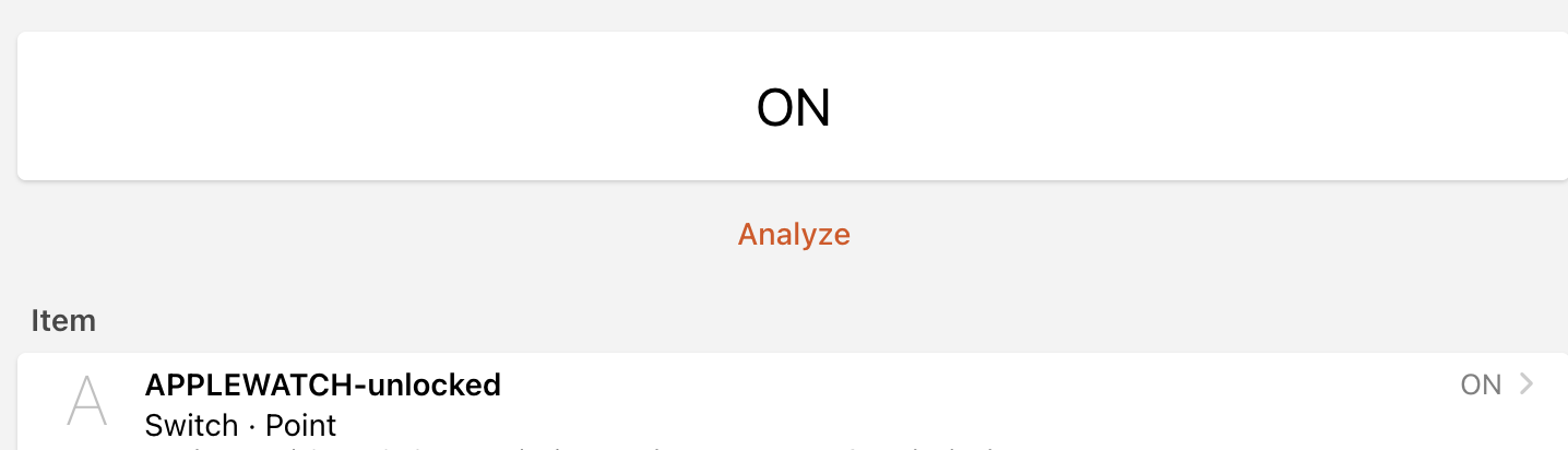

Only the Apple Watch, which has a more verbose value template, implemented for security reasons to automatically set it to LOCKED when the device tracker is recognised as AWAY, with
"val_tpl": "{% if value_json.get('unlocked') is true -%}True{%- else -%}False{%- endif %}"
correctly discovers and immediately displays its unlocked state.

I have to admit that I didn’t even try discovering a BLE device_tracker as a binary sensor, due to the issues stated just above, but also because HA distinctly differentiates between device_trackers and binary sensors. it would probably work, but also mean that every MQTT implementation, not just us, would need to duplicate all their local device_tracker discoveries, one the fully HA native way and then the OH half-HA way, with user having to make sure they do select the correct preferences setting before they have anything discovered.

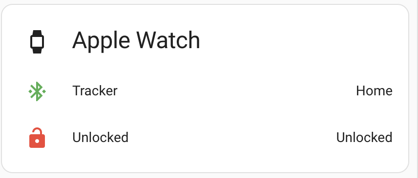

In HA, an Apple Watch discovered by Theengs Gateway is shown in the Inbox, and only one single click on the Add to Sahboard (page) button is required to get this
with the correct Bluetooth device tracker icon and lock icons included due to the information in the discovery messages.

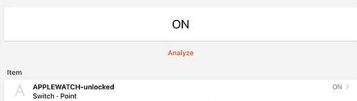

Yes, I have a Mac and had no problem getting my IRK. I did notice that I never see "unlocked": true in the state message on my iPhone 16 Pro running iOS 18.2 beta. But that’s not really relevant to openHAB’s implementation of the Device Tracker component.
I assume you mean with the unlocked binary_sensor on an Apple device? I’m getting a proper OFF value for an item linked to this channel, but it was NULL until Theengs Gateway published the next update, since the message isn’t retained.
yes, this is a know issue still for some users, and was mentioned in the original presentation post I deleted again out of frustration. unfortunately all my iPhones and iPad work as expected, so do all the device’s I had access to from friends, from ancient devices running iOS 12 to 18.1.1
I’ll either need to get my hand on an iPhone where it doesn’t work to debug the decoder or see which setting might make the difference, or the unlocked key needs to be removed in the future for iPhone. hence also the Apple Watch screenshot above, where it is working perfectly for everyone :wink:
If you do have a HomePod, see whit it makes any difference after you AirPlyed some music to it from your iPhone, one user reported that this was all it took for him to have it working as well.
No, the unlocked key was fine, as it has the verbose value template
but any of the other mentioned device, the Inkbird TH1 with an external probe socket had a constant NULL, even when the published MQTT messages from it had
“extprobe”: true
with the discovery messages with a less verbose value template for binary_sensor being
	"name": "IBS-TH1/TH2/P01B/ITH-12S-extprobe",
	"pl_off": "False",
	"pl_on": "True",
	"stat_t": "+/+/BTtoMQTT/AABBCCDDEEFF",
	"uniq_id": "AABBCCDDEEFF-extprobe",
