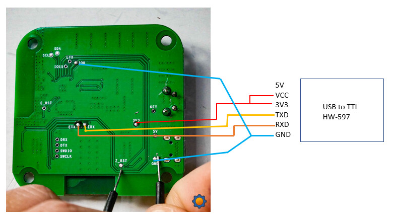

I’m using CH340 USB TTL module and connect to Sonoff Zbbridge as diagram below
The sonoff zigbee bridge show permanently green light after connect USB to my laptop
Then I’m trying to flash it with Tasmotizer and It’s appear error: Failed to connect ESP8266. Time out
even I tried with PyFlasher. It’s also cannot connect to esp8266 module. like with Tasmotizer.
I’ve also try switched between TX RX. The result still the same.
Are there anyone here facing this problem before?. Or did I’ve done anything wrong?

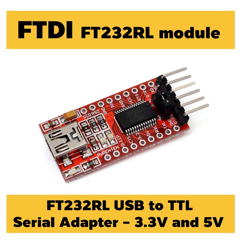

After asking help from tasmota discord channel. They told me to change to “better CH340G usb ttl”
Then I decide to order these module
image image
Let’s see if the new “better CH340G” and FT232RL can work. :grin:

I had this problem with my kettle and others have had the same problem with the ifan03
The issue is that you are connecting to an already used serial line and trying to communicate on it.
The ZigBee chip is connected to those tx and rx lines that you also have to connect too. A better ttl programmer may drown out the ZigBee chip and may work.
The safest is to remove the ZigBee chip and replace once flashed with tasmota or short it out and program it before you break something.
You could try and connect zreset and gnd to stop the zigbee chip from trying to talk
The problem already solve after use new FTDI Programer for flashing. Thanks everyone!
