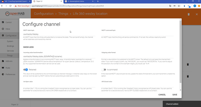

what i have done now is created a channel:
MQTT state topic: owntracks
incoming value transformation: JSONPATH:$.owntracks.status.Wesley
:sweat_smile::grimacing: really have no Idea how to set this up.

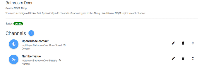

PaperUI - Things - + - MQTT Binding - Add Manually - MQTT Bridge (Insert the details of your MQTT broker)
Then
PaperUI - Things - + - MQTT Binding - Add Manually - MQTT Generic Things
Choose a Name
Choose an ID
Choose a Bridge
Open the things
Add Channels - Insert the parameters as required
Go to the things - It will display the channels with the channel names:
Copy the channel name and put in the items file:
Contact  Bathroom_Door                      "Bathroom Door [%s]"                            <door>      (Doors, Bathroom, Persist, MQTTv2)                     { channel="mqtt:topic:BathroomDoor:OpenClosed" }
i did this already but it doesn’t work.

transformation pattern = JSONPATH:$.locname
