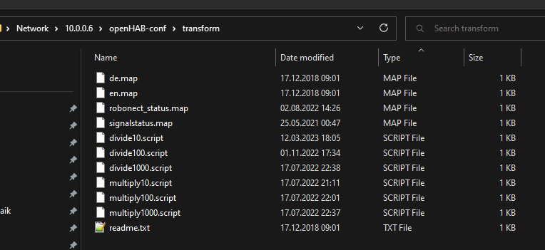

and to confirm … the file seems to me in the right spot:
Assuming openHAB-conf is the config folder OH is working off of that looks correct. I know others have managed to get the transformation to work. Maybe there is something unique about that binding? Or maybe the file permissions are off and OH can’t read the file?
