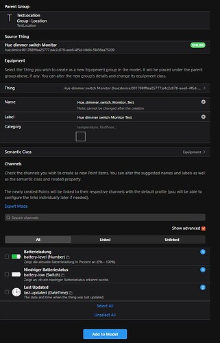

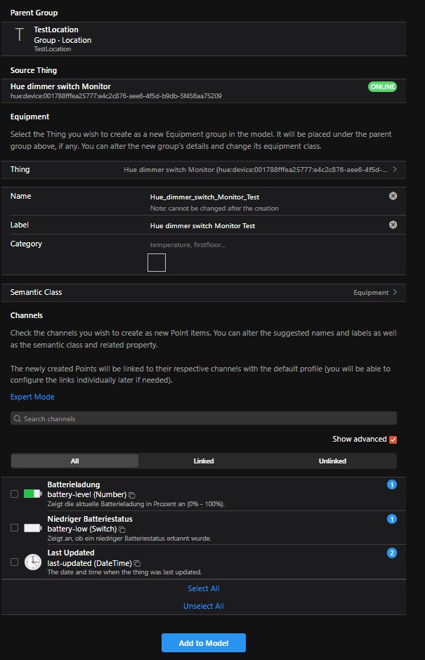

After setting up the Hue Binding, on an new OpenHAB 4 installation the HUE Dimmer Switch Things where discovered and they can be added as a Thing.
When adding this Items as Eqipment there are only the 2 Channels for Battery load but no Channel for the State of the Button, so there is not a chance to react on a button state.
Is there anything to do to get the Button Events linked to the Equipment in the Model?

Thanks for all that suggestions - in my “old” installation I create the Equipment and select the needed Channels to get linked. Actually when I want to do so there is nothing to select not even a button-last-event entry. So I might be wrong with creating the equipment there … but where do I get the button-last-event
