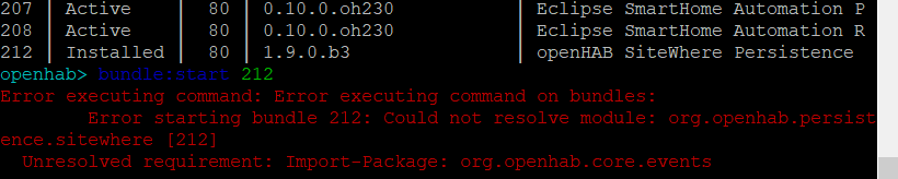

I’m trying to run the addon SiteWhere Persistence because I’d like to use it’s CEP-Capabilities.
I downloaded the .jar form SiteWhere Tutorial and copied it into usr/share/openhab2/addons. Then I tried to start it via the Karaf Console but I’m getting an error:
Can anybody tell me how to get this to work?
As you can see, your jar is 3 years old.
This likely won’t work, you would need an up to date binding jar, and preferrably one for openHAB 2.
Thanks for your reply :slight_smile: I found a newer version of the SiteWhere Binding but it’s still not working:
Do you have an idea where I could find the latest version of that Binding? Or is it possible that SiteWhere is not usable with OpenHAB2 ?
It’s obviously an openHAB1 addon. You could try setting legacy = true in /etc/openhab2/services/addons.cfg but I doubt it helps, and if it does not then sorry no it won’t work.

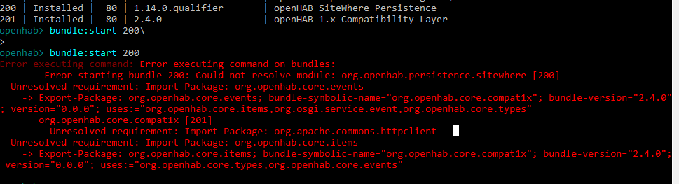

Hi, I’m the newbie to openHab.
I’m trying to modify this StieWhere Persistence using the org.openhab.core.compat1x-2.4.0 jar.
But I’m getting this error
Can you tell me how to get this work?Thanks!
