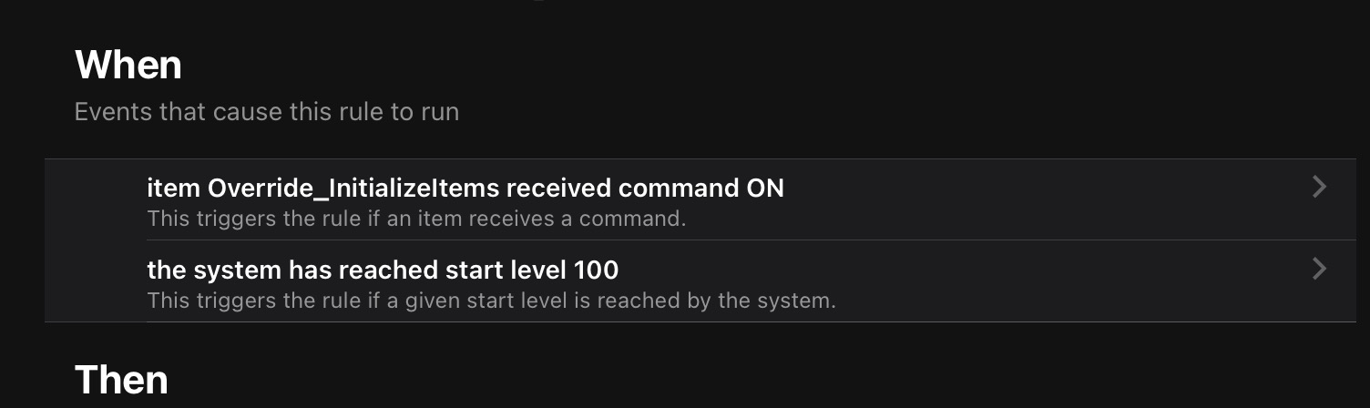

Somehow, it doesn’t get triggered when the system reaches level 100 (as you can see in the logs below). I have set the level to 80, but it still doesn’t work. The log level of the file where the rule is located is set to DEBUG, but not even the first line gets printed.
I have also tried it without the item command
triggers: [triggers.SystemStartlevelTrigger(100)

When I try to trigger it with the item command, I see the command in the logs, but still the rule doesn’t get triggered.

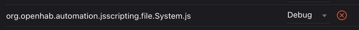

Here is also the log level for the file where the rule has been defined.

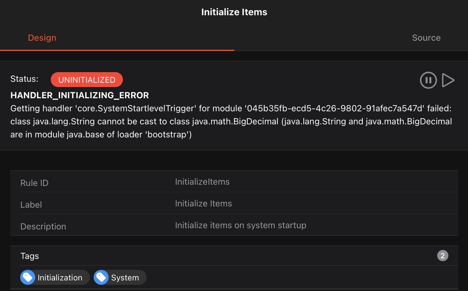

When trying to run it from the MainUI I found the following error message:
Getting handler 'core.SystemStartlevelTrigger' for module '045b35fb-ecd5-4c26-9802-91afec7a547d' failed: class java.lang.String cannot be cast to class java.math.BigDecimal (java.lang.String and java.math.BigDecimal are in module java.base of loader 'bootstrap')

I don’t understand why that error is not showing up in your logs. I’m not sure where or what logger is responsible for logging it but it definitely should be logged when the rule is first loaded.
That seems to be the root cause of the problem. The rule is in a broken state and an UNINITIALIZED rule cannot be run under any circumstances.
That doesn’t mean the error makes sense though. As far as I can tell it looks syntactically correct. You are passing the start level number as a number. I don’t seen where it would be trying to cast a String to a BigDecimal anywhere here.
To see if the problem might be elsewhere and it’s just showing up here, what happens if you simply eliminate the triggers (i.e. pass an emptry array for the triggers)? Does the error go away in the UI? Does it change? Can you manually run the rule now?
Then add back the Item received command trigger. Does the error come back? Can you manually run the rule? Can you trigger the rule by sending the command to the Item?
Finally, add back the system started trigger. If the error is only there with the system started trigger, there might be something wrong with the openhab-js library. What verision are you using? (note you can install the openhab-js library separately which is why I ask.)
Do you get the same error with the rule builder?
Without triggers, it didn’t show any errors on the MainUI; I could also run it manually, and the logs were created.
Only with the ItemCommand trigger does it also get loaded and run by sending the command to the item. However, once I add the SystemStartLevel trigger, I see the error again (only on MainUI).
By the way, even though there is an error, I can see that MainUI can somehow parse and display it:
About the version of the JS library, I’m using auto-injection and caching the injection.
That narrows it down to the trigger.
Whatever is wrong is not widespread. There are thousands of users with SystemStartlevel triggers in use from .js files and this is the first report of the problem so there must be something unique going on here.
Next steps I think are:
  1. move the rule to a different position in the file just to make sure there isn’t some hidden character or syntax problem from some other rule in the file causing the problem.
  2. install and run with the latest version of the openhab-js library. There have been many changes made to it since OH 5.1 was released. You can either upgrade to the latest 5.2 snapshot or install the openhab-js library separately using NPM (instructions are in the docs)
  3. if that still fails file an issue.

I swapped the position of the rules as @rlkoshak suggested, and now I can see the message in the logs:
info_circle 06:28:41.543	INFO
org.openhab.automation.jsscripting.openhab-js.rules
Adding rule: Initialize Items
info_circle 06:28:41.546	INFO
openhab.event.RuleStatusInfoEvent
InitializeItems updated: UNINITIALIZED
info_circle 06:28:41.547	INFO
InitializeItems updated: INITIALIZING
info_circle 06:28:41.550	INFO
InitializeItems updated: UNINITIALIZED (HANDLER_INITIALIZING_ERROR): Getting handler 'core.SystemStartlevelTrigger' for module 'b41967c9-1e6e-4f80-bf83-f42281135ef5' failed: class java.lang.String cannot be cast to class java.math.BigDecimal (java.lang.String and java.math.BigDecimal are in module java.base of loader 'bootstrap')
info_circle 06:29:00.281
Even after reducing the rule to the following, the same message was there
rules.JSRule({
    description: "Initialize items on system startup",
    triggers: [triggers.SystemStartlevelTrigger(100),
        triggers.ItemCommandTrigger('Override_InitializeItems','ON')
    execute: () => {
        console.debug("System Actions> Initialize Items> Starting.");
        console.debug("System Actions> Initialize Items> Initializing scenes.");
        console.debug("System Actions> Initialize Items> Ending.");
    tags: ["System", "Initialization"],
@rlkoshak, can you also reproduce the error? That way I can create the bug.
I don’t have acces to write a rule as a text file right now so I can’t test this out. If I remember I can try later today but I wouldn’t wait on my to file an issue.
I tested to create that rule (and create an Item with the appropriate name) on my local development setup, only changing the logging to warn since I don’t have debug logging enabled for that namespace. This is what is logged during OH startup:
20:31:53.488 [WARN ] (le-InitializeItems-1) [tomation.jsscripting.file.bugtest.js] - System Actions> Initialize Items> Starting.
20:31:53.489 [WARN ] (le-InitializeItems-1) [tomation.jsscripting.file.bugtest.js] - System Actions> Initialize Items> Initializing scenes.
20:31:53.490 [WARN ] (le-InitializeItems-1) [tomation.jsscripting.file.bugtest.js] - System Actions> Initialize Items> Ending.
20:31:53.491 [DEBUG] (le-InitializeItems-1) [e.automation.internal.RuleEngineImpl] - The rule 'InitializeItems' was executed.
I can’t seem to find any error logged. So, I’m not sure that a bug report is needed.
I’m running this on latest 5.2.0 with these two still unmerged patches that deal with some issues related to startlevel triggering, among other things:
I can’t say for sure if any of the above PRs specifically solves the problem, or if it has been solved previously (since 5.1.3), but as far as I can tell, it’s running fine with these PRs.
Hi, guys.
I’ve an update about this topic. I finally had the chance to upgrade to 5.2.1, and the rule is no longer Uninitialized on the UI, plus it seems to have run after a restart.
It seems there was an issue with 5.x.x versions.
Thanks for your support.
