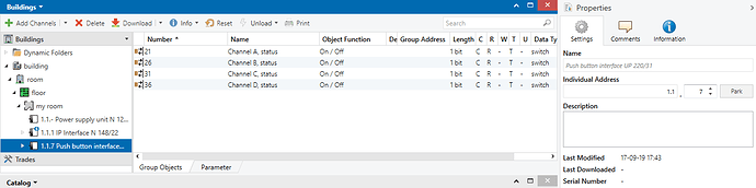

- Siemens Power supply unit
- Siemens IP interfaces 148-1AB22

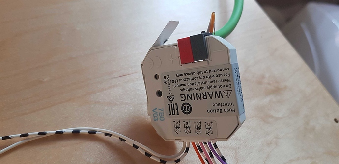

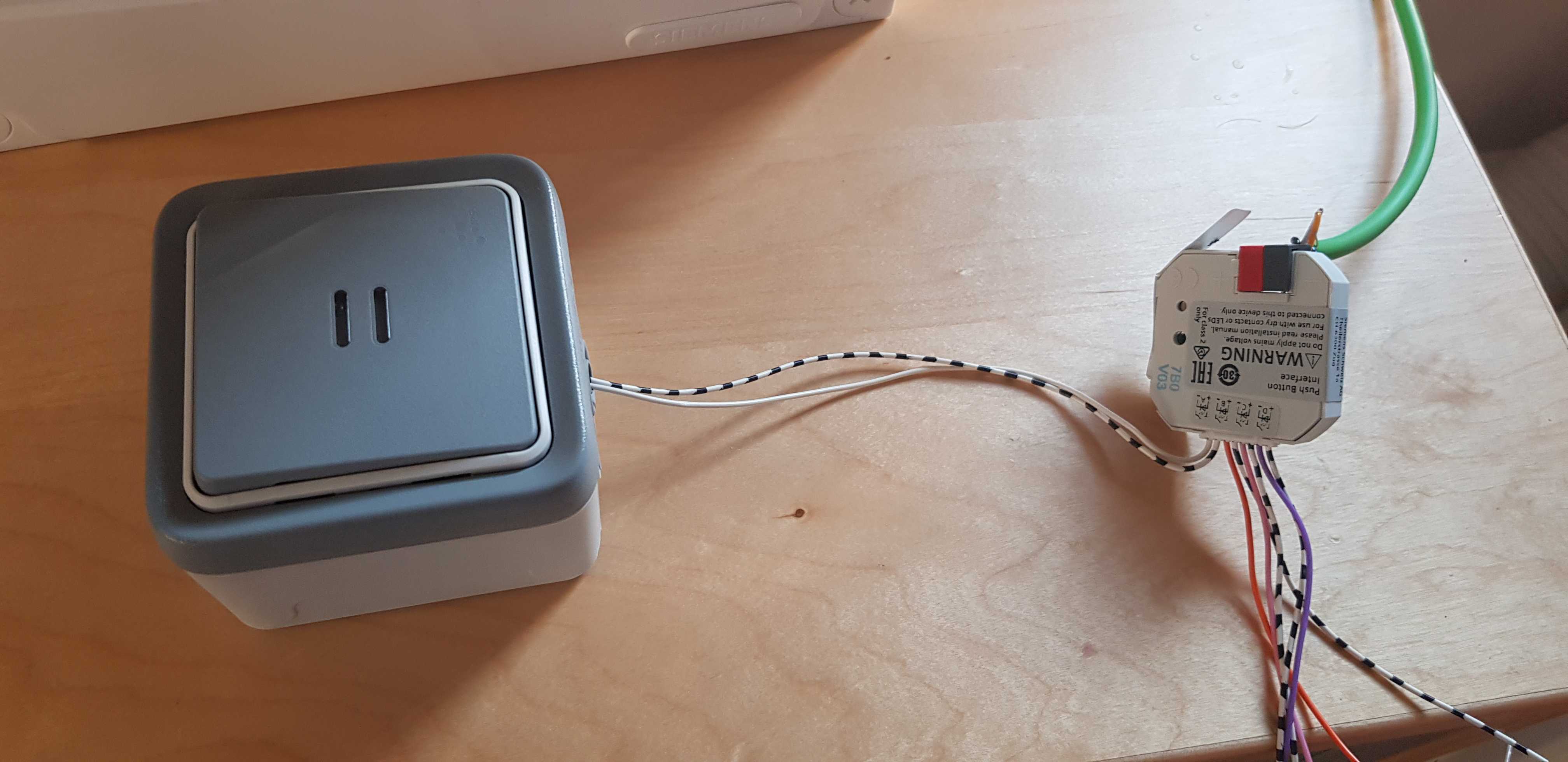

- Siemens push button interface 220-2_B31
These are the pictures of my setup which works fine (I think) as I can see the telegrams on ETS5.

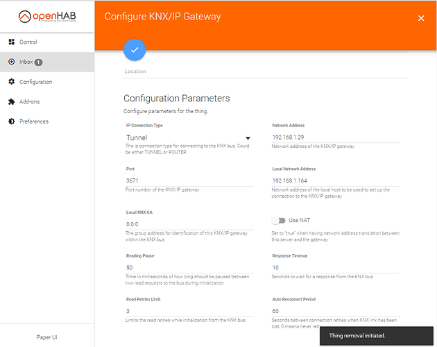

My configuration for the IP gateway is as follows (and I can see it online)

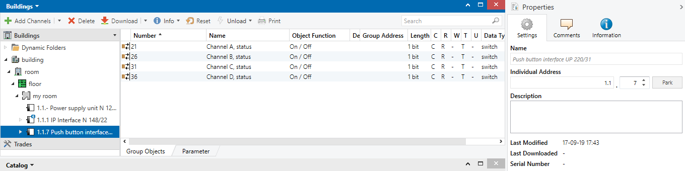

Now my question is how to configure the switch as I have not been able to see it online and, least of all, being able to capture the event.
No matter what I put in the address field (e.g. 1.1.7 or 15.15.225), I always receive in the log the following error:
2019-09-17 17:54:24.248 [WARN ] [calimero.link.192.168.1.29:3671 ] - negative confirmation of 15.15.225: 2e00b160ffffffe10080

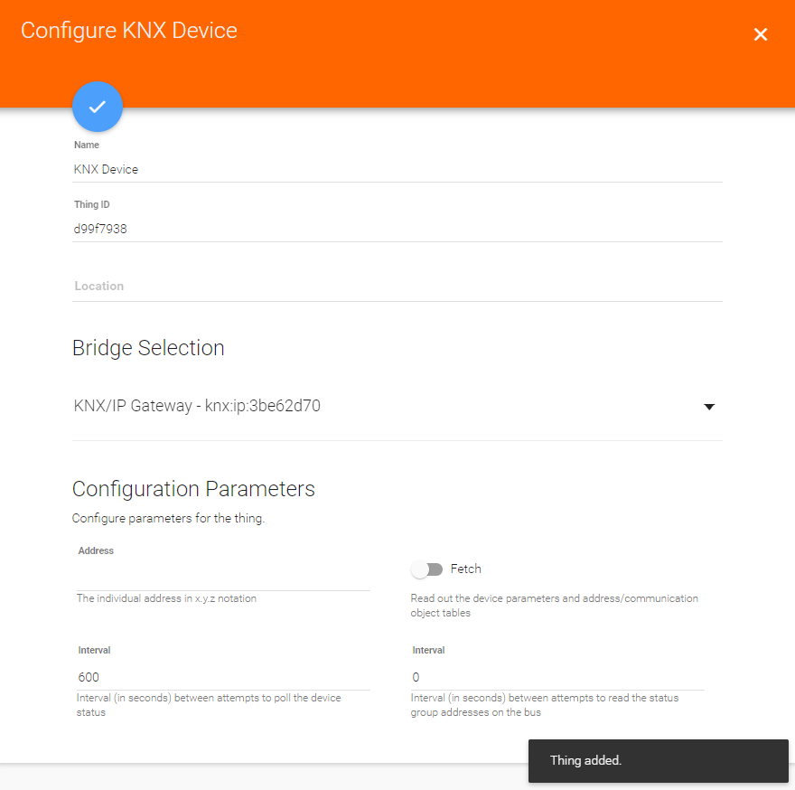

I addition I have tried to configure the things configuration as follows:
Bridge knx:ip:bridge [
type="TUNNEL",
ipAddress="192.168.1.29",
portNumber=3671,
localIp="192.168.1.164"
Thing device KNXBus [
address="1.1.1",
fetch=true
Type switch:myswitchs "My thing" [ga="1.001:2/4/0+<2/4/1"]
and
Switch MySwitch "This is my thing" {channel="knx:device:44aacde2:KNXBus:myswitchs", autoupdate="true"}
