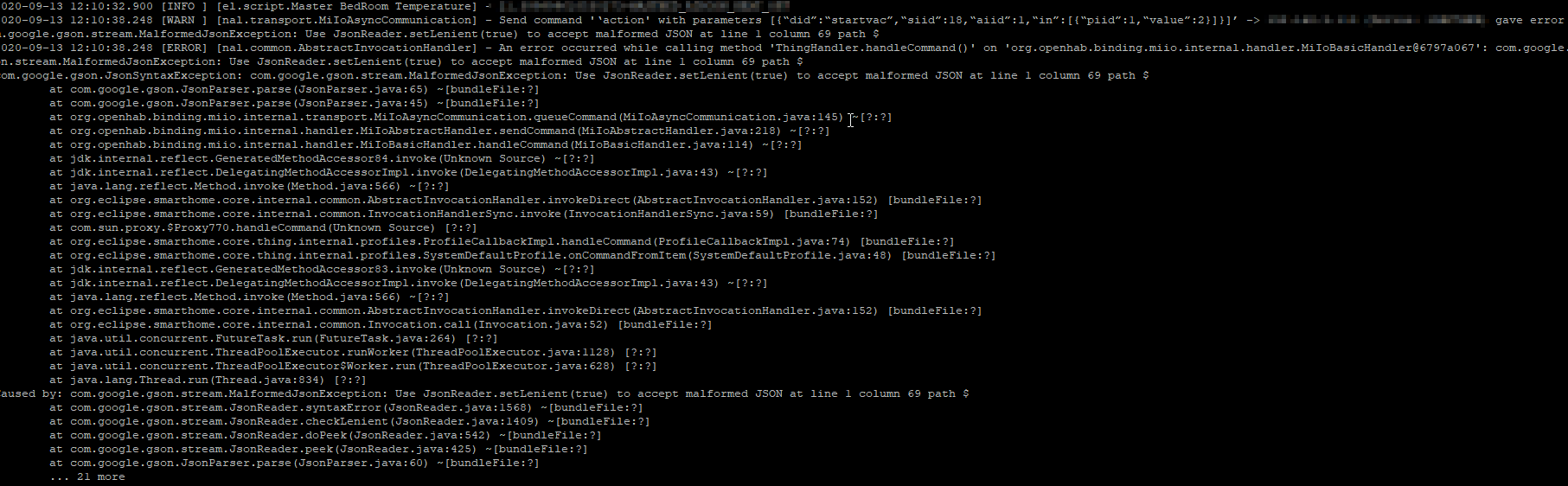

I get the error
I think it is an issue due to the ," smartness" of the forum/Windows during copy / paste
The quotes are changed from double quotes to open & close quotes..
Hard to see, tricky but gives this error
Txt version..
2020-09-13 16:16:57.307 [WARN ] [nal.transport.MiIoAsyncCommunication] - Send command ‘‘action’ with parameters [{“did”:“startvac”,“siid”:18,“aiid”:1,“in”:[{“piid”:1,“value”:2}]}]’ → 192.168.xx.xx (Device: XXXXXXX) gave error com.google.gson.stream.MalformedJsonException: Use JsonReader.setLenient(true) to accept malformed JSON at line 1 column 69 path $
2020-09-13 16:16:57.307 [ERROR] [nal.common.AbstractInvocationHandler] - An error occurred while calling method ‘ThingHandler.handleCommand()’ on ‘org.openhab.binding.miio.internal.handler.MiIoBasicHandler@6797a067’: com.google.gson.stream.MalformedJsonException: Use JsonReader.setLenient(true) to accept malformed JSON at line 1 column 69 path $
com.google.gson.JsonSyntaxException: com.google.gson.stream.MalformedJsonException: Use JsonReader.setLenient(true) to accept malformed JSON at line 1 column 69 path $

Looks like the wrong double quotes are still there. At least in your text copy/paste
After the copy/paste manually replace all double quotes. That is the only way to ensure they are the right ones

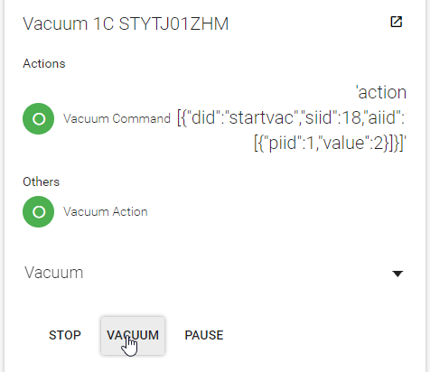

Okay.. I can see from the screenshot the quotes look right… If you remove the single quotes at start and end it probably works.
Is the vacuum channel below not working? It should send the same command
removing the single quotes at both ends did not give an error.
but it did not work as well. Vacuum did not respond
The Vaccum Action is not working as well
Can you try to put the binding in debug logging, so we can see what is the actual communication / response from the device. (in console type: log:set debug org.openhab.binding.miio than type log:tail org.openhab.binding.miio )
As I look once more in the screenshot, it seems actually part of the command is missing I was expecting:
action [{"did":"startvac","siid":18,"aiid":1,"in":[{"piid":1,"value":2}]}]
but I don’t see the ‘:1, “in”’ in your screenshot

Thanks for the log
One thing I see is that I made error with the vacuum channel… It expects a text like ‘vacuum’ but the channel maps to a number :frowning: I’ll fix that in the coming days.
Unfortunately the response to your custom command is not in the attached logfile.
Did I do something different? Let me know.
what I did was copy the command with the correct format, then click the check mark. This is reponse I got from sending the command (debug mode). but in normal log, it did not do anything.
I made a quick fix version with improved string channel
you can download it here https://verpaalen.com/openhab2/org.openhab.binding.miio-2.5.9-SNAPSHOT.jar
Before installing (dropping it in the addons folder), ensure to uninstall the existing version of the binding.
Please test it and let me know if it works. I anyway would appreciate a debug log to see what the device actually responds to these commands.
Wrt to the log: It seems the responses section starts bit late, the command id = 9492 but the first response is nr 9562… hence looks like (the relevant) part of the log is missing. For the rest the type of logging is the right one. Maybe you can surround it with ``` type of quotes (3 of them) as than the quotes are not transformed and be kept how they are really in the screen..

Marcel, thank you for your work
I downloaded snapshot of miio binding from your site.
When using action channel with
action [{“did”:“startvac”,“siid”:18,“aiid”:1,“in”:[{“piid”:1,“value”:2}]}]
and dreameControl channel nothing happens.
In logs there is the same line - “No response from device”

Thanks for the log
Can you try these 2 if they start the vacuuming:
action[ {"did": "startvac", "siid": 2, "aiid": 1, "in": [] }]
action[ "did": "startvac", "siid": 2, "aiid": 1, "in": [] ]
Can you also check if you send “stop” to the vacuumaction channel that it stops the vacuuming in process or “dock” to return to the dock.
