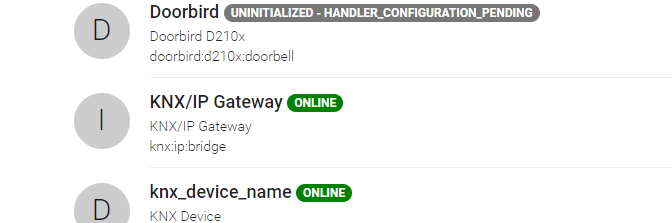

Out of the logs i get the following message:
2020-05-14 12:28:36.483 [hingStatusInfoChangedEvent] - 'doorbird:d210x:doorbell' changed from UNINITIALIZED (HANDLER_CONFIGURATION_PENDING) to UNINITIALIZED (HANDLER_MISSING_ERROR)
2020-05-14 12:28:36.501 [me.event.ThingUpdatedEvent] - Thing 'doorbird:d210x:doorbell' has been updated.
In PaperUI → Configuration → Things there’s a similar error code description:
Do i miss something?
Thanks in advance!

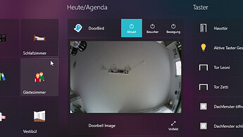

Works like a charm
Thank you very much & stay healthy!!!
