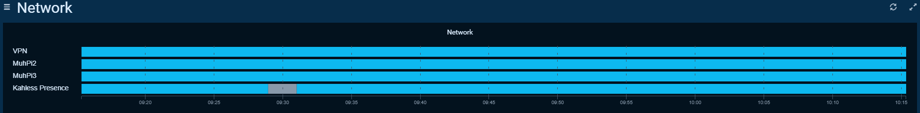

Then i added the Timeline widget, chose “mysql” as the Service provide and added some of my servers in the “Series” tab as a OpenHAB item.
The server gave me the following error messages:
[sql.internal.MysqlPersistenceService] - mySQL: Unable to find table for query 'network_servicedevice_192_168_1_49_80_online'.
Where/How can i tell the Network binding to write its data to the DB (and use it in the widget)?
