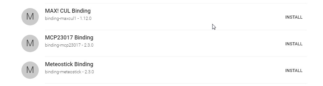

I’ve uninstaled default and copied your to /usr/share.. and after rebooted but where I can find configuration for this binding ? In binding list I have only old one
It should be visible in PaperUI in configuration/bindings.
Yesterday I made clean install of raspbian with openhab 2.3.0.1 and it worked ok:
If it is not visible, check logs, maybe there is some info
ok, I’ve upgraded. I have quite complex home automation systems and it takes some time. But it seems it works.
