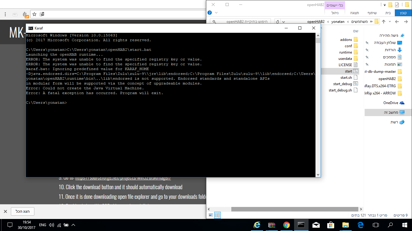

Problem with openhab 2 in windows
can you help me i dont understand what i do wrong

Please use start.bat instead of start.sh (start.sh is for GNU/Linux while start.bat is for Windows machines)
Ok where I can find this file and how I open this ?

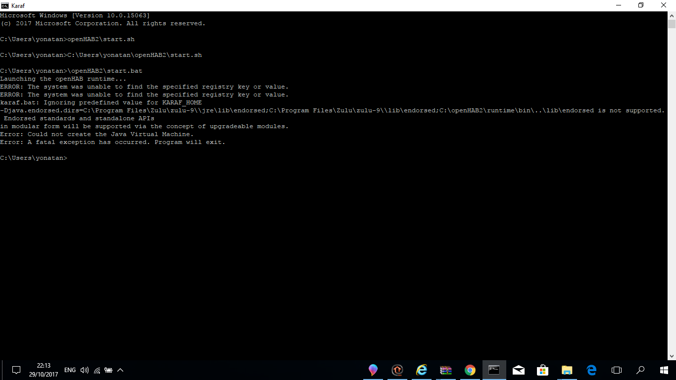

i tried start.bat but stil its didnt working.

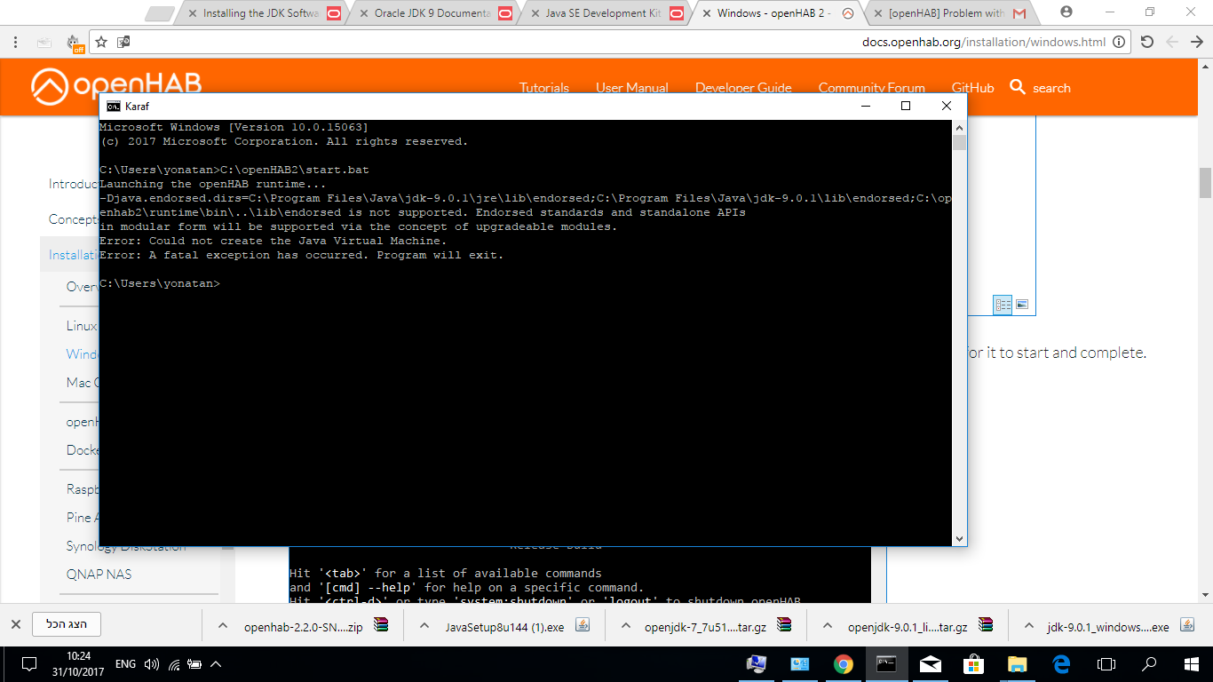

i install java home but its stil not working
mybe someone can share the exactally jdk that i need to install ?
i think JDK is not fit for my windows.

openHAB is not yet compatible with Java 9. You need to install Java 8.
