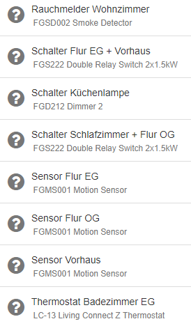

That´s not correct. It´s no new installation. This installation runs over 1 year. UIs were there
but gone after a restart of my Raspi. Setting it back to “Expert” brought the UIs back, but
my Z-Wave-Things now looking like this under HABmin:
So what can i do now?

It looks like you have updated from 2.3 to 2.4.
In this case you see some breaking changes in the zwave binding which can easily be solved: deleete all things and readd them (don’t exclude/reinclude).
Read the breaking changes for the release notes and this post:
