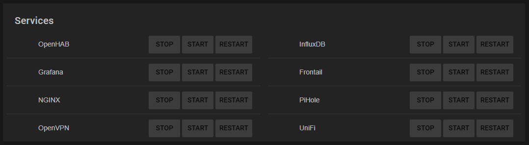

Screen grab showing the service commands (I know I cannot start openhab from BasicUI as this would assume it’s not running hence it would not work, but left it in for aesthetics)

Looking at the commands in my things I’m sure this should all just work but alas it does not
Please help! (apologies for the super long post)
