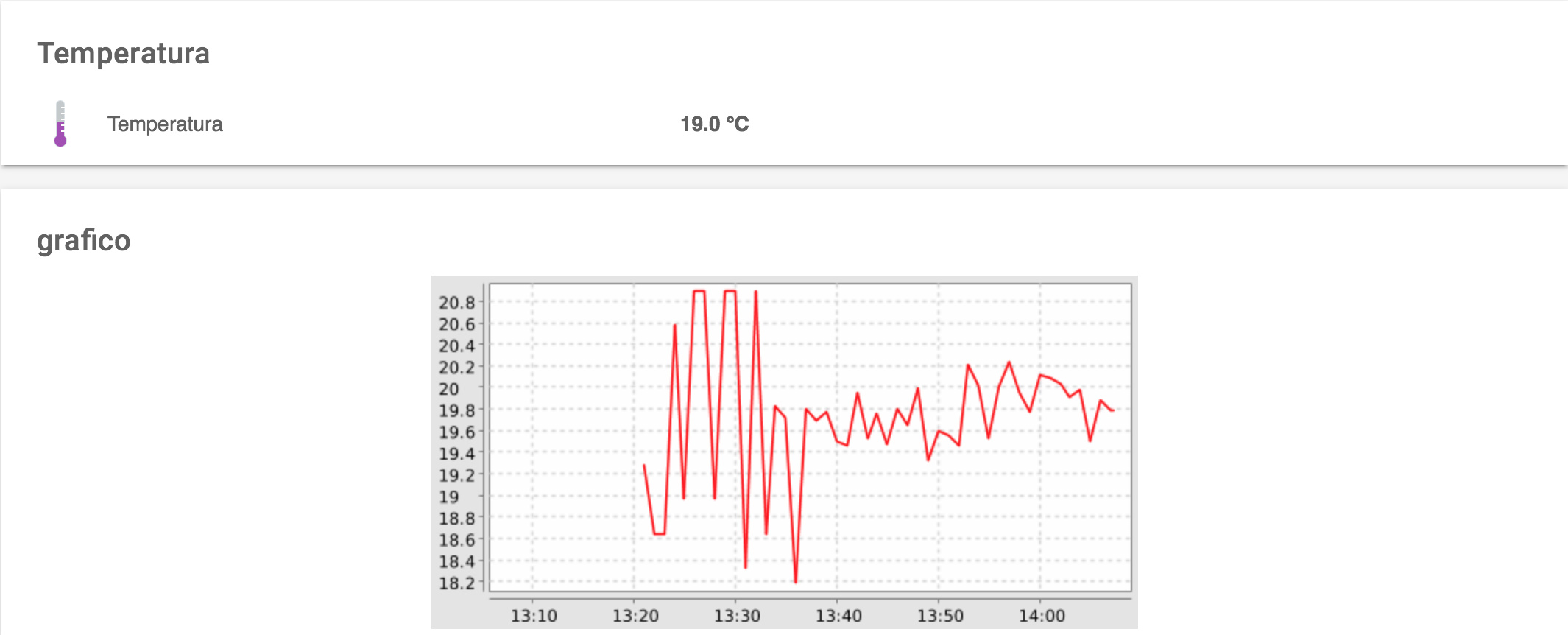

I’ve got some problems to figure out how it works to display a simple Temperature chart.
rrd4j.persist file

           Chart item=temperatura period=h refresh=30000 service="rrd4j"

The graph works, but not well and not how I want.
How you can see, it show the value, but not in real time, and some value are lost.
Example: in the photo the temperature is set to 19.0° , after it is changed al lot of time (the sensor is not accurate), and some value, like the 19.0°, doesn’t appears in the graph. How can I solve it? I try to set refresh in the sitemap file at lower or higher value but it seems doesn’t change.
