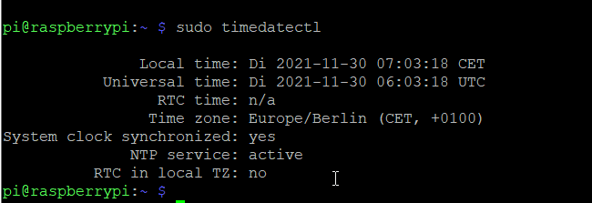

Actual I have the problem that my scheduled tasks are one hour delayed. It looks for me like a problem with the UTC and CET timezones.
But schedule in OH 3 shows (tasks in the past will not be showed)
hardcopy from the same time like the first about system time
has someone na idea what I forget.

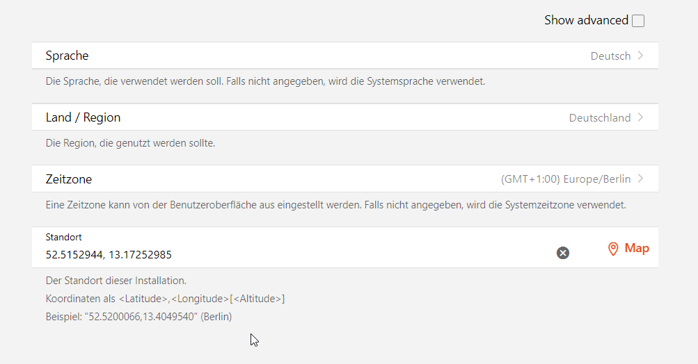

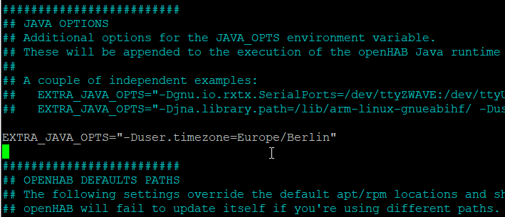

And yes, I tried to used the integrated functionality in OH3 to schedule rules. In the past I done it in a rule itself, time as event and this works well. I agree with opus, it looks like that schedule used another timezone - from where no clue. System itself is Europe/Berlin, OH is Europe/Berlin and Java too. There is no posibility to say UTC or CET. That can be only the reason why I have 1 hour difference in the schedule function to the real time / system time.

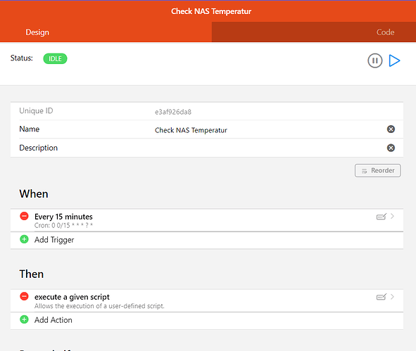

The schedule task looks
I wondering because it looks like a normal cron task
I have made now a lot of change which I found. Set cron from UTC to CET, change location in OH3 to none, then system time will be used. But al without any result.

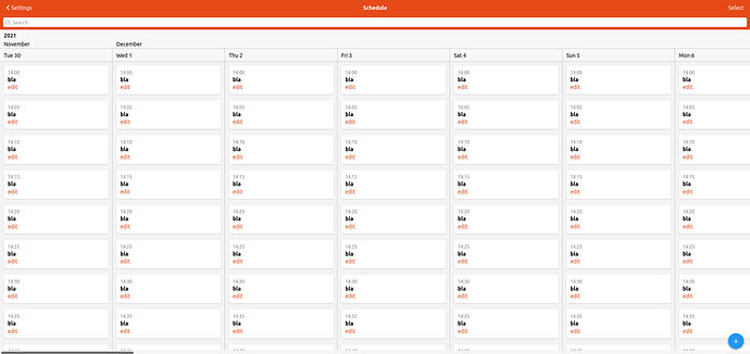

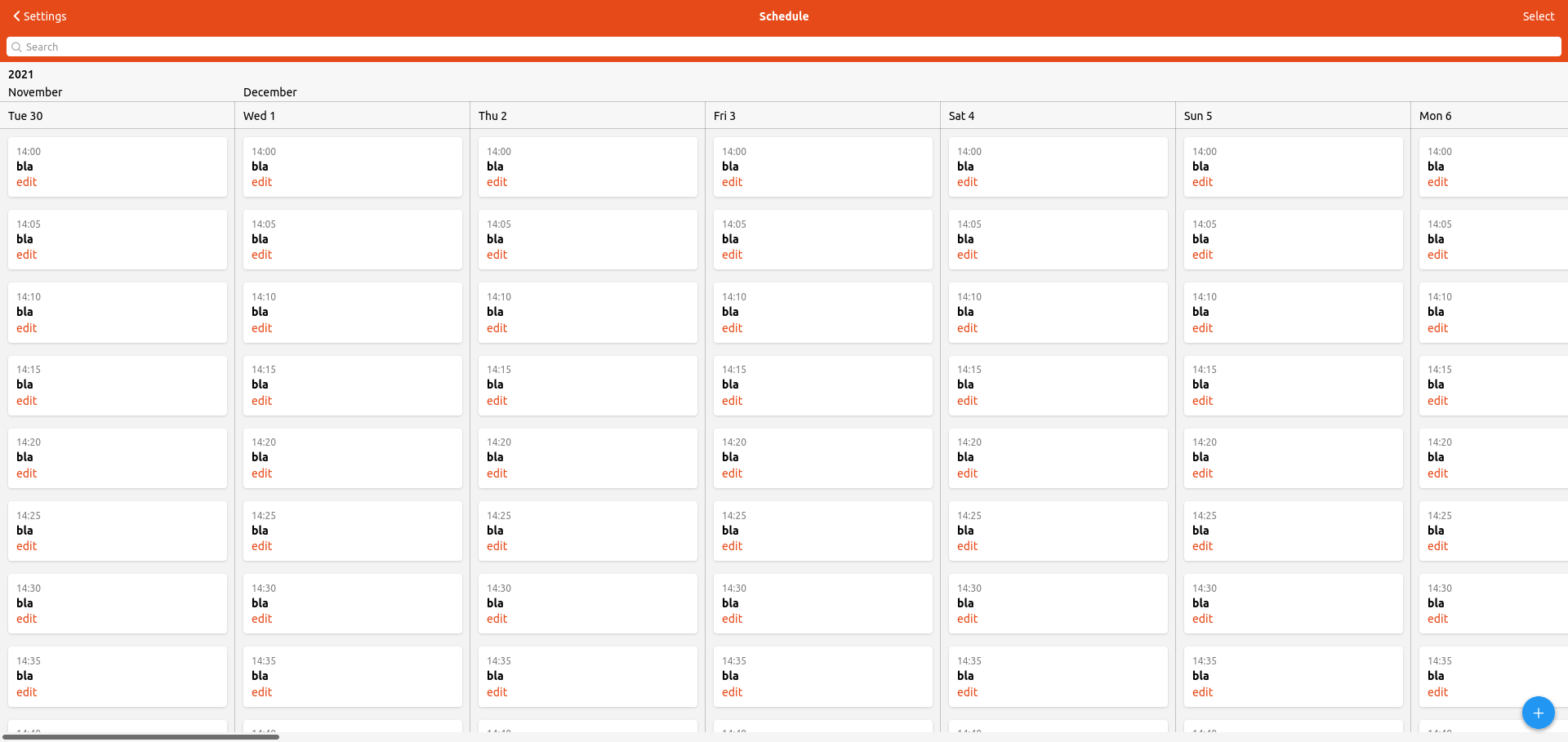

That is strange as far as I understand I did the same setup of the schedule e.g. via browser and the relatd code is:
triggers:
  - id: "1"
    configuration:
      cronExpression: 0 0/5 14 * * ? *
conditions: []
actions:
  - inputs: {}
    configuration:
      text: bla
    type: media.SayAction
So it should run every 5 minutes between 14:00 and 14:59. Which it seem to do:
fgrep bla /var/log/openhab/openhab.log
2021-11-30 14:50:00.043 [WARN ] [core.voice.internal.VoiceManagerImpl] - Error saying 'bla': No TTS service can be found for voice null
2021-11-30 14:55:00.042 [WARN ] [core.voice.internal.VoiceManagerImpl] - Error saying 'bla': No TTS service can be found for voice null
and it is also displayed so:
I am also in CET timezone, Germany. The only thing that may be different is that I am using english language settings.
EDITed: this is OH 3.1.0-1
Yes and No, the interesting thing is, that you schedule the bla task I guess at aprox 14:46 o’clock. Normally the schedule overview shows only tasks in the future. Then the overview would start with first next task at 15:00 o’clock but you can see in your overview it starts at 14:00 a’clock - if I have a task which comes up every 5 mins or in a definied time interval it isn’t a “real” problem. Actual I have a switch which switch on at 5 in the morning but it switch at 6 - that’s the reason why I recognized it. All other things like Time Display, logs,… are ok, only the schedule pages has this problem.

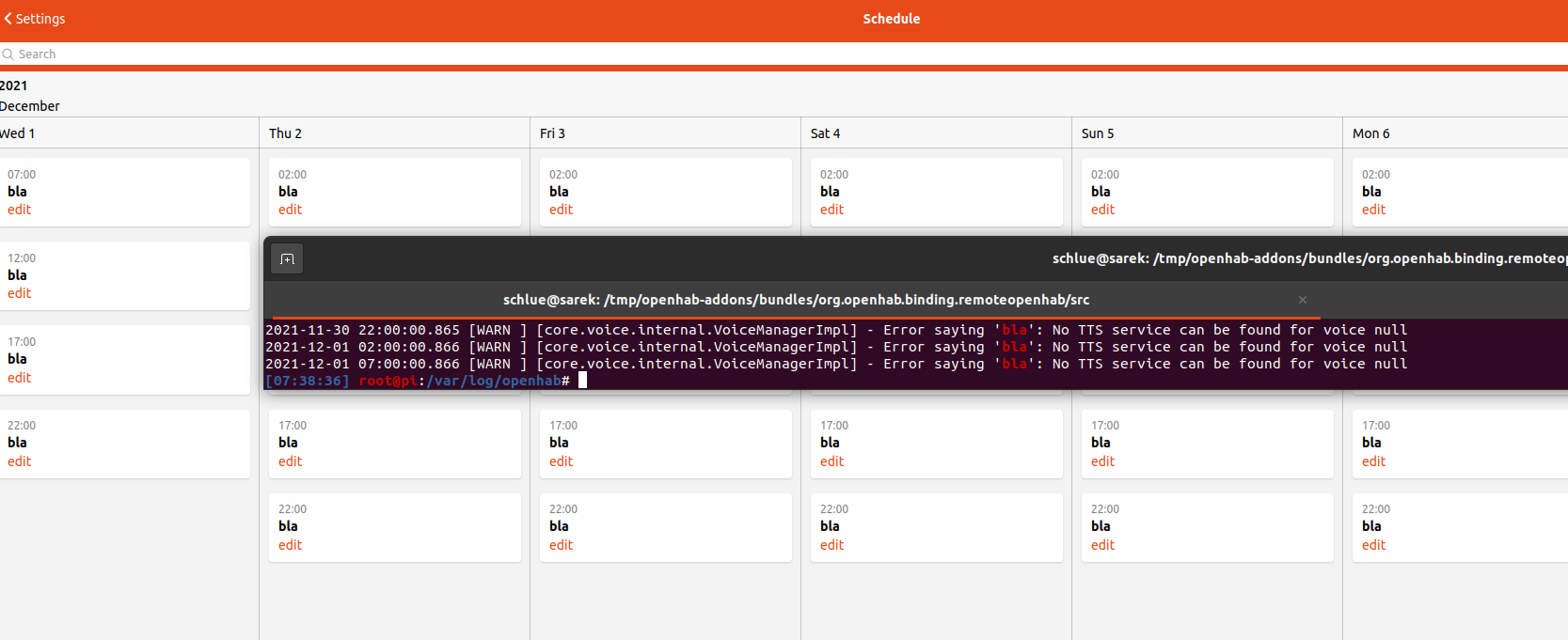

Another trial: Yesterday evening before 22:00 CET I created a new schedule.
Starts at 02:00 in the morning and repeats every 5 hours.
That is also ok. I used repeated schedule because your first screenshot also shows them.
Is this wrong understand and the problem at your site is only with a daily repeated schedule ?
I think this boils down to a minor UI issue. The events are executed correctly, but the schedule page displays events that are in the past (e.g your 7:00 event is displayed even though that time has passed already, your screenshot was taken 7:40 according to the file name)
that is correct
I agree, thats a minor issue. "The events are executed correctly, but the schedule page displays events that are in the past " - > yeah, in the first moment I thought the time is wrong because the executions was also 1 hour delayed but after reset the cron job and reload the schedules it works correctly. No clue why …
